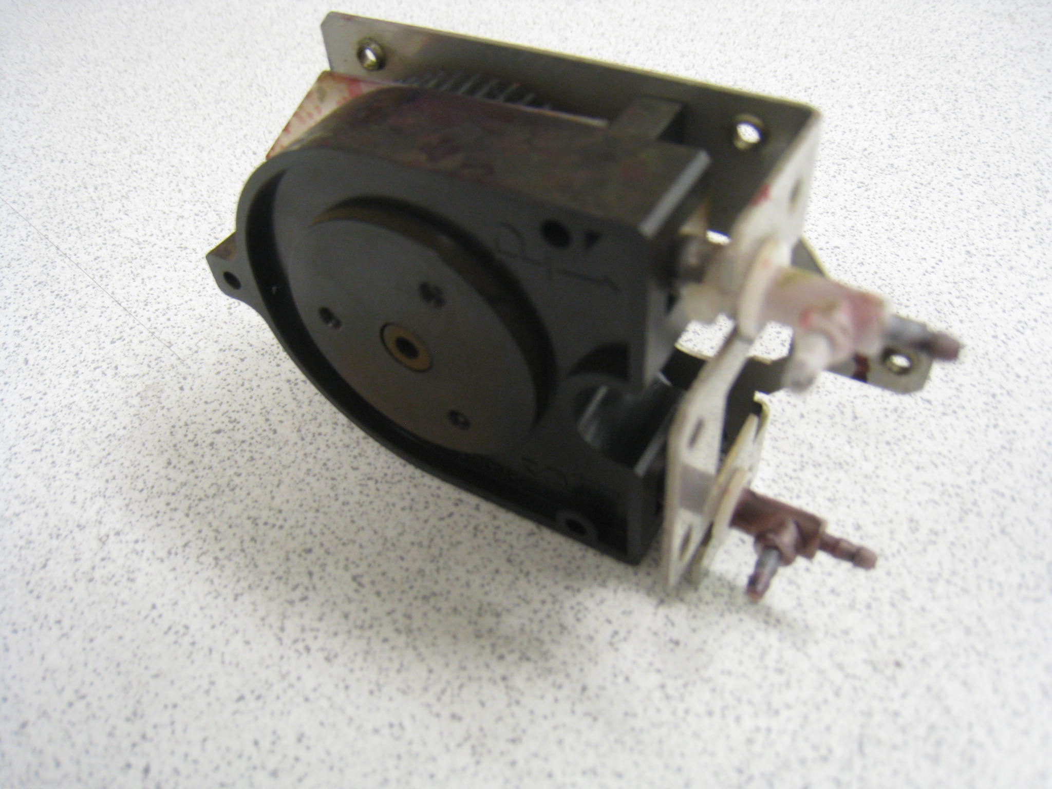

    I’d say pump. I’ve not seen it on Roland machines before as they run a different pump (or at least the later ones do). On the JV3 (which uses the same head setup and the same pump as the early Roland), the Epson style pumps would occasionally not lock off properly and syphon the ink into the waste tank. If you can put up a picture of you pump I can tell you if it’s an Epson style pump or the later style Roland sub-pump.
    Stafford
    23 September 2016 at 07:39
    This is the type of pump fitted
  • Stafford Cox
    23 September 2016 at 07:42
    Ah, right. Not an Epsom type pump then. It could still be at fault but not as likely. I would probably put a new genuine pump and all dampers on and be done with it. It will pay for itself ink empty ink carts before long.
