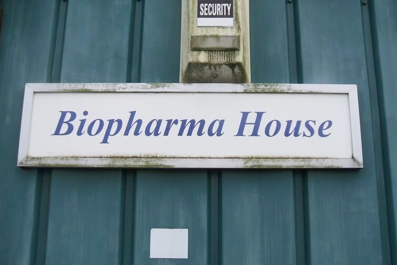

Posted by Warren Beard on 1 November 2007 at 17:30Hi All
This is an easy one for you all as it is very common but I cannot find anybody who supplies it and how it works.
Help please.
Warren

just looks like a variation of a standard panatrim frame, Warren, they do it in a small section for ickle signs
Universal Panatrim UCL 142 if it measures 32mm on the face.
One end should have a screw at edge end (other end riveted).
Otherwise it could be Eurotrim 100 (30mm across the face) with barbed knock-ins one end and screws the other.
Many extrusions about though will be virtually identical. -
Hi Guys
I didn’t think it was a Panatrim style as I thought they had a bit of a recess like the picture below where this almost looks like the board is stuck up against the inside front angle of the frame with vhb tape or something 😕
I have never seen or made any Panatrim frames so this is why I thought it was different.
Hi All, I’ve got to supply a sign like this, approx 1m x 500mm/ Where is the best place to buy panatrim or eurotrim from and also why do you place a strip of foamex along the top of the sign.
Cheers John
John, there are quite a few suppliers of frames I use Cherwell good service and they will make them up, complete with panel.
Reason for strip, its not as important when using composite sheet, but its to allow the foamex to stay flat without buckling, and twisting, if it was just resting on the bottom edge, again not so important with smaller signs,
but on larger depths 3′-4′ it is necasaryPeter
