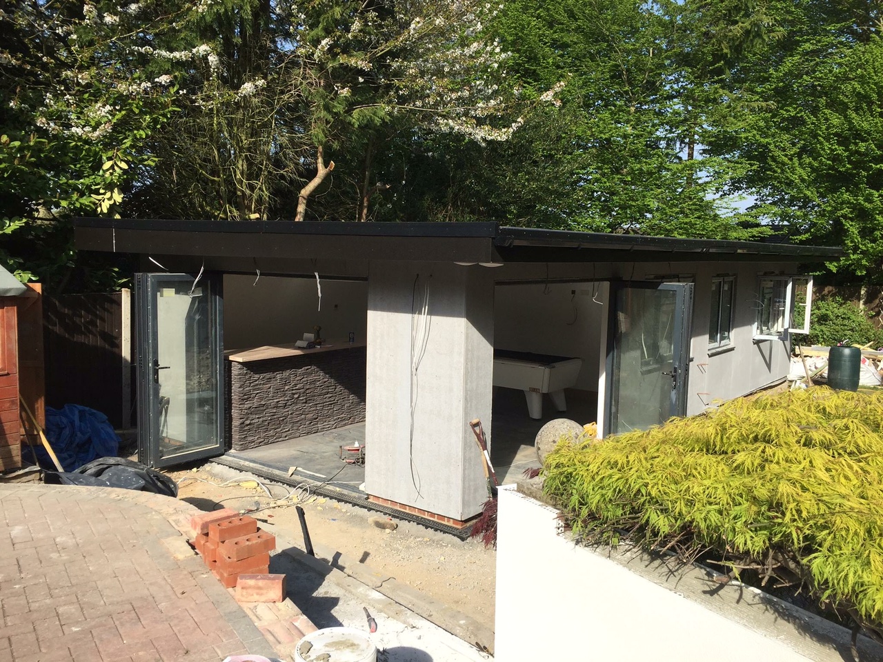

    In short he has just built a large mancave / outbuilding in his garden, it has a bar, gym, bathroom plus room for swimming pool pump etc. Above the large door he would like the name of his bar(!) to give it a more ‘party feel’ I have suggested to him perhaps acrylic lettering in a deep cerise pink colour (he has a daughter who loves pink) spaced outwards and mounted onto another piece of acrylic which in turn could screw onto the soffit. He has space on the face of his soffit to have the sign, around 300mm high to play with and approx a metre of so wide ideally.
    I’m not in the acrylic / sign type game (more vinyl / digital print) so does anyone have suggestions to what he can do or can point me in the right direction? Please see attached photo, the location of the sign is above the door on the left hand side on the black soffit.

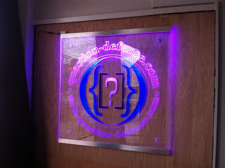

    Have you thought about offering him something like the attached.
    Its an edge lit acrylic sign….We have made a few of these for the trade and these can be fixed to the wall.
    You could even put in a RGB controlled and have the LED’s changing to the mood, can be controlled with a remote and would be alot cheaper then £1000 give us a shout see if we can help you out on this one.

    I like that James, very nice.

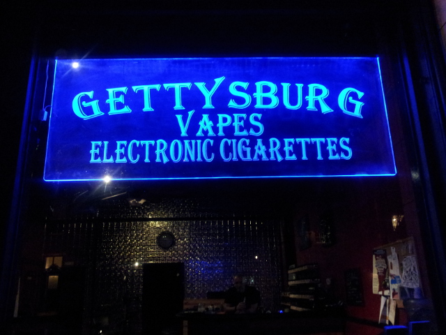

    Here is one we sent all the way to America….This was a for a friends place.
    This was on a RGB controller and a remote and our friend loved it.

    the gettysburg one james, is the acrylic engraved, and could u acheive a similar effect with frosted vinyl on edgelit acrylic ?

    I don’t see why not David!

    The Acrylic panel is fed with LED light along the horizontal edges, the light within the sheet is collected by the engraved ‘v’ notch and illuminates as the machined finish is matt. You do not in particular need to use ‘edge lit’ Acrylic to achieve this, any clear standard material will also work, up to >500mm light spread.
    Laser etching will also work but applying vinyl’s such as frosted will not. The acrylic sheet surface has to be distressed to absorb light and refraction directs the collected light perpendicular to the surface of the sheet.
