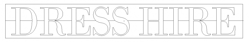

    The perfect weeding pattern?

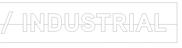

    Hi everyone.

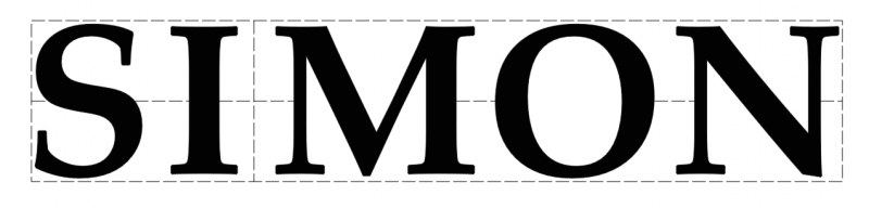

    I find this to be the best weeding pattern I have ever used.
    The cut line down the middle between the letters divides the weeding box in half, and you can pull the top and bottom away from the word itself and the letters have much less of a tendency to follow the waste up off the backing sheet, which is a real problem with some vinyls. It seems you can never get the cutting pressure exactly right.
    I saw it a long time ago as a plug in for one of the proprietory sign making programs, I cant remember which one, and I have been trying to reproduce it in Illustrator ever since, I just can seem to get Illustrator to automatically get rid of the cut line through the middle of the letters. I still have to do this by clicking and deleting each segment.
    For this reason I only use this method when its going to be a real time saving, ie loads of the same sentence repeated.
    Here is the sequence I use to get this pattern:
    1. Outline the text
    2. Draw a horizontal line through the middle of the text
    3. Select all : pathfinder; outline. This divides everything into segments.
    4. INDIVIDUALLY Delete the line segments where it cuts through any part of each letter. (ugh!)
    5. Draw a weeding box round everything.
    Does anybody know of a better way to achieve this? The actual weeding is sooo much easier and quicker, specially with very small letters. But setting it up takes away much of that advantage.

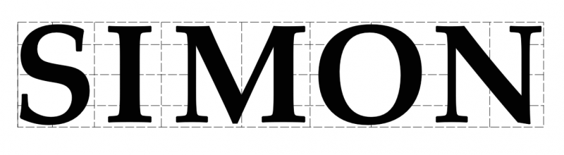

    I “think” I know what you mean, in Signlab it is called Easyweed.
    you can take any text or graphic and just drag as many cut lines as you want into the path of the vector and it turns into a cut line for you to make easy weeding.
    you can have one line or a hundred lines to divide it up. is this what you mean mate?

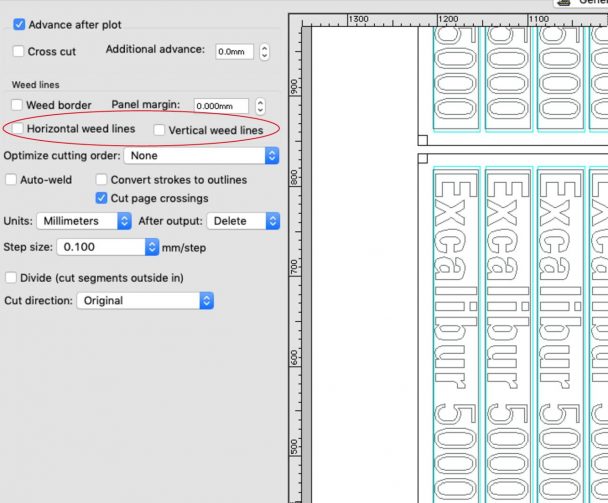

    22 July 2021 at 08:11
    Which plotter do you have? FineCut for Mimaki has this built in, as does Cutting Master for Graphtec. It might be worth checking your plotter plug-in to see if it has it.
  • Martyn
    22 July 2021 at 09:27
    Yes as jamie said, cutting master has it built in. Does everyone use weed boxes? not something ive ever used, i just normally scalpal a line down the middle as i go

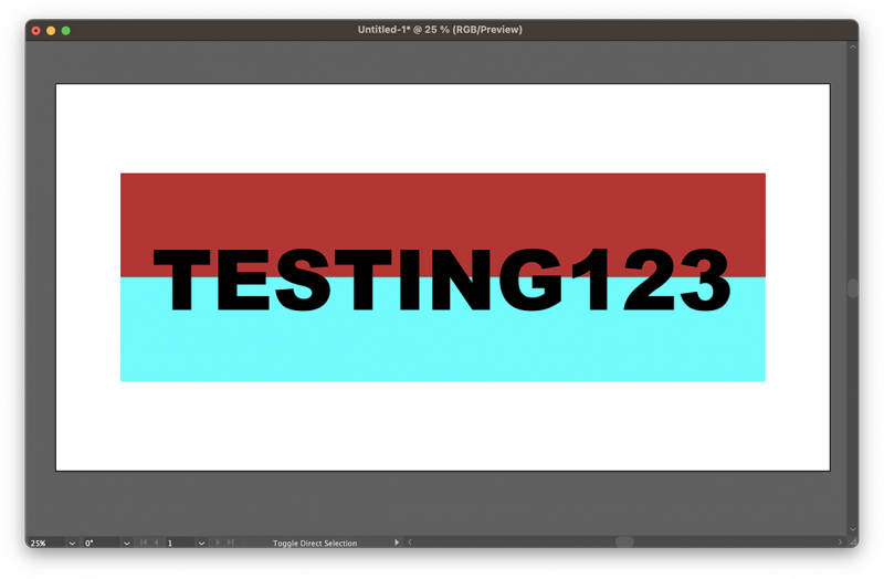

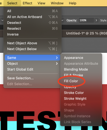

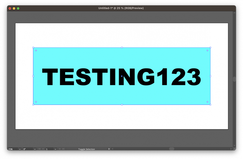

  • Cian Byrne
    22 July 2021 at 20:10
    Just tried this out and it seems to work. Images attached.

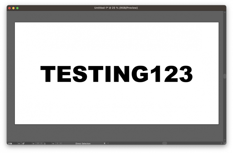

    1 Outline Font, make it a colour
    2 Draw a box behind the font. Pick a colour that different to text
    3 Duplicate the box, change to another colour and drag it halfway. Doing it that way because if you draw 2 boxes and butt them together you can end up with 2 cut lines right next to each other, this will give you a single line in the end.

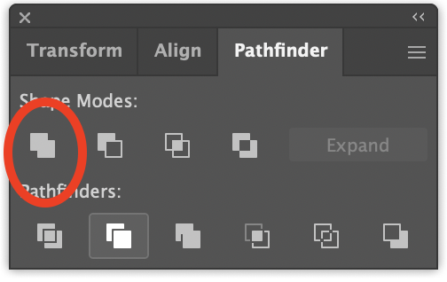

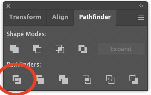

    4. Select everything, and use Pathfinder Divide tool. This splits the artwork up in individual pieces
    5. Click one of the black text pieces using the Direct Selection Tool, and go to menu Select>Same>Fill Colour. This will select all the text pieces.
    6. Back to Pathfinder, use the Unite Tool. This joins the text back together.
    7. Select everything, take off fill, and put on stroke.
    Hopefully that works for you.

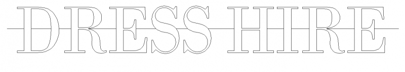

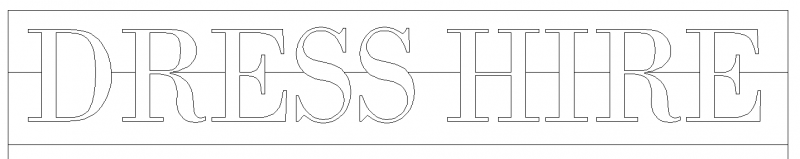

    • Simon Worrall

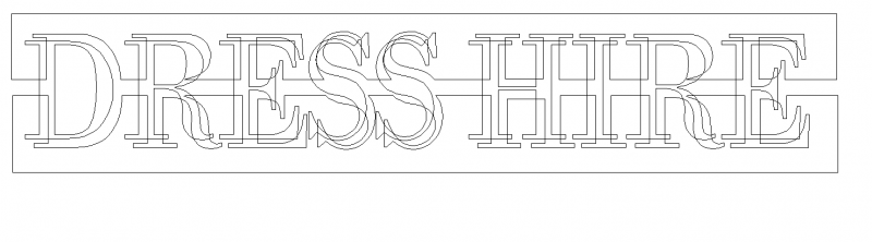

      22 July 2021 at 23:11
      Thanks Cian, nearly there, but this leaves me with double lines: Second image pulled apart to show…

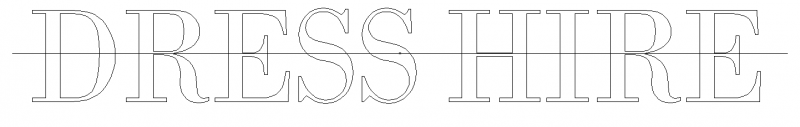

  • Simon Worrall
    22 July 2021 at 23:21

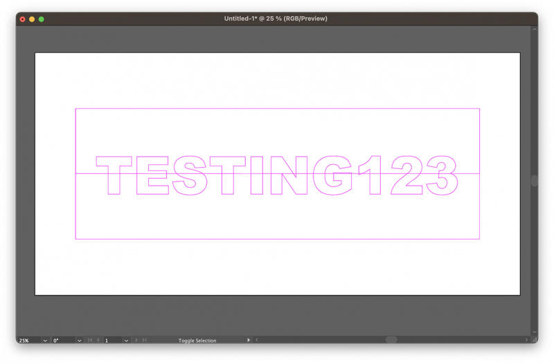

    I think Ive almost got it now:
    1.Outline text, horizontal line through middle of text, line must be BEHIND text.
    2. Select all.
    3. Pathfinder:merge.
    4. Draw weeding box around everything.
    5. There is stll some double lines inside the text islands to clean up though, but they come up without any fill colour, so its easy enough to select them all together and delete them.
