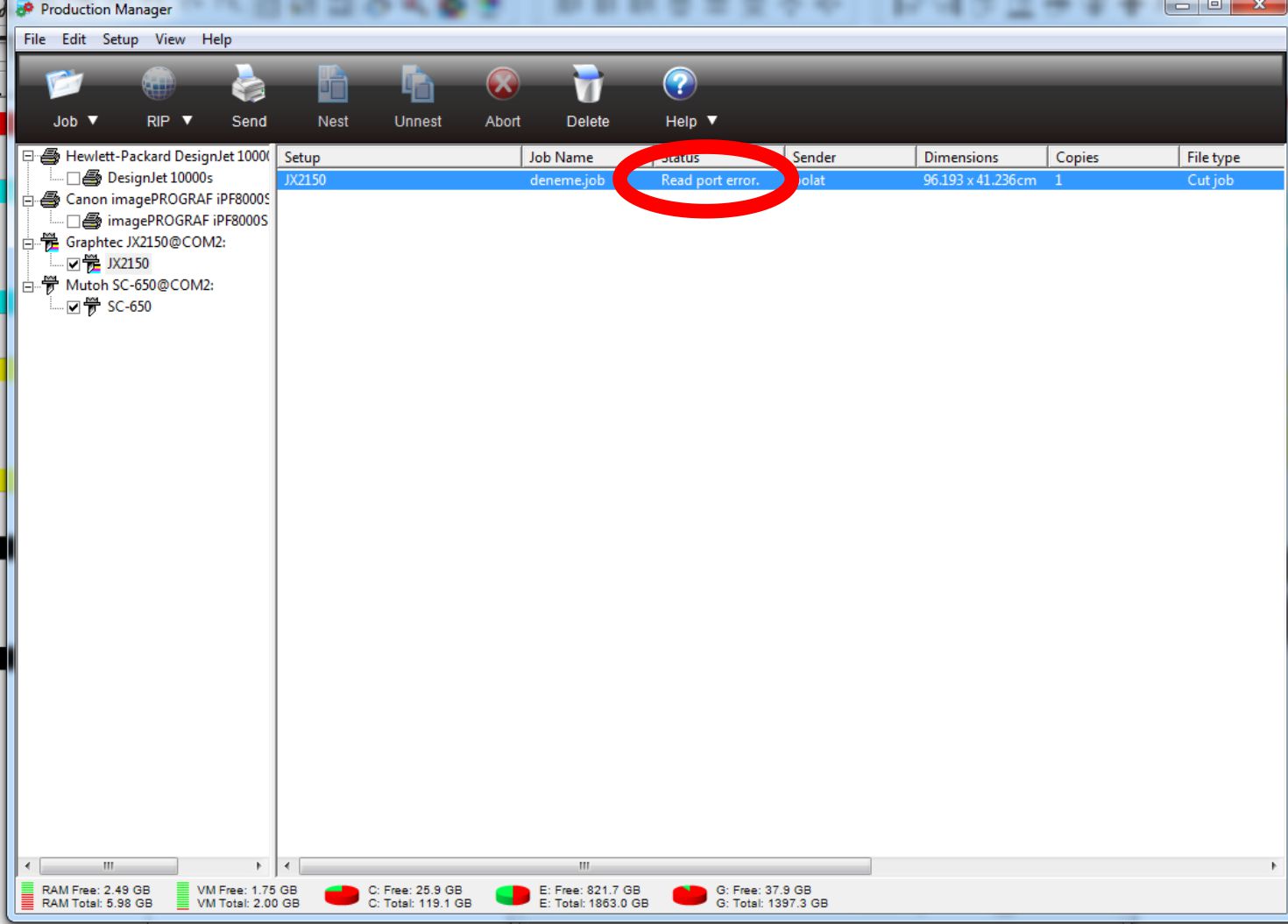

    I was try many type of cable for connection (serial modem cable,Nulled modem cable and last one) but when software nead the read data from Plotter (for registration mark alingment in Flexisign) communication problem appered -read port error

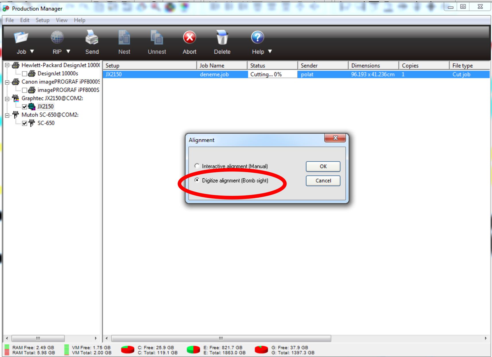

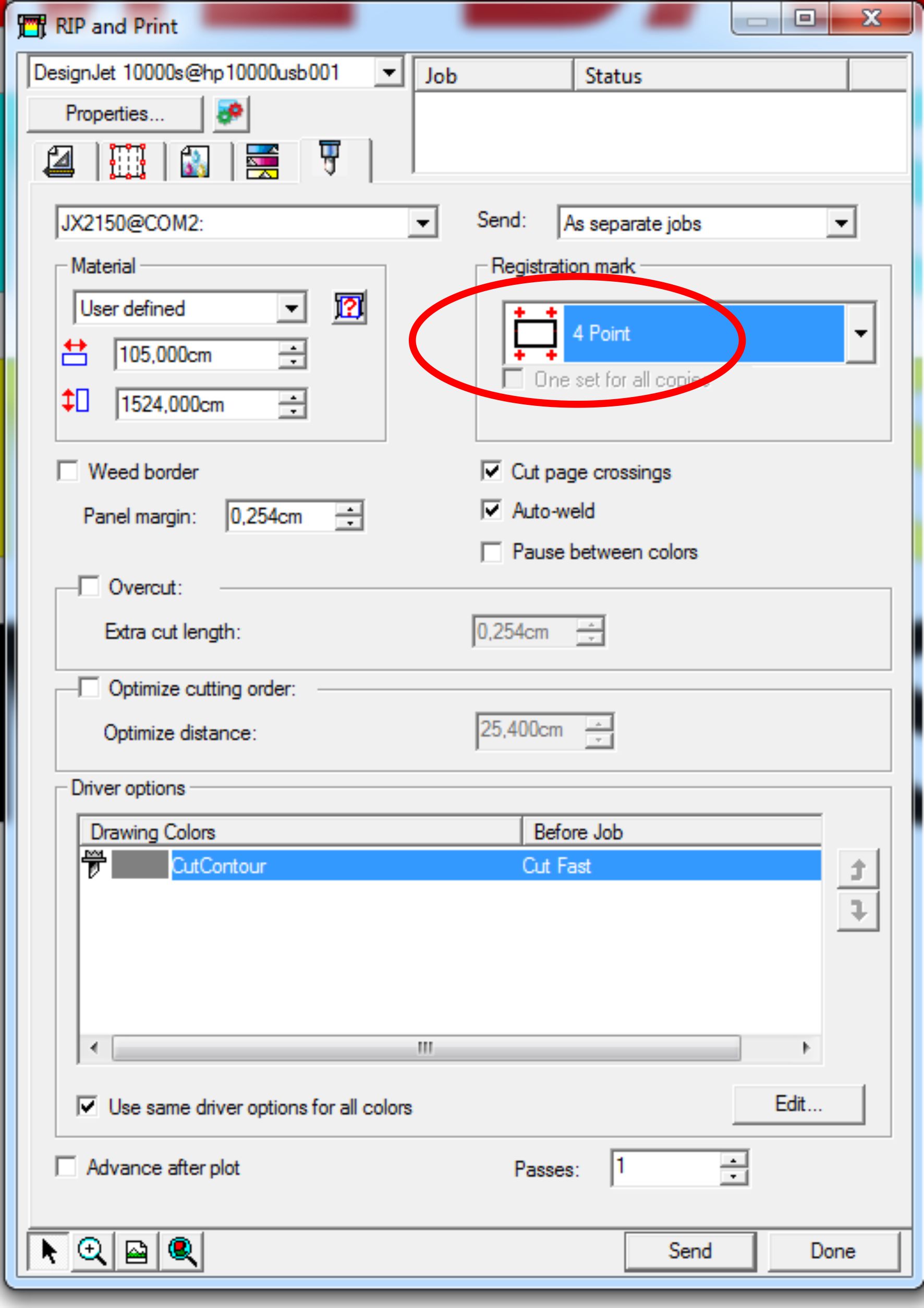

    When I try counter cutting with the flexisign registration marks (2point vertical or horizantal or 4 point registration marks)
    usualy I recive "read port error" in flexisign

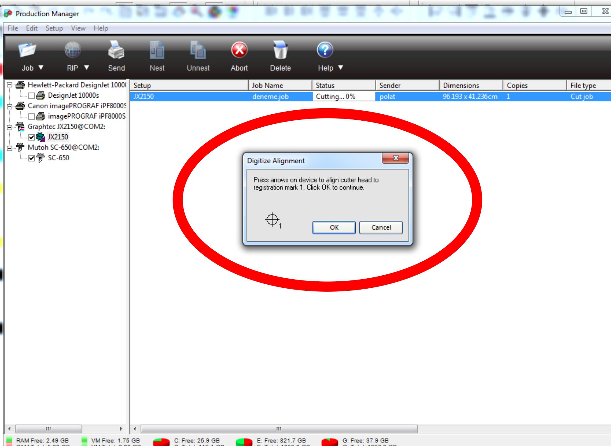

    sometimes it is working and filexisign want to second,third and fourt registration mark one by one and I move the cutter head each registration point .
    When the start cutting job plotter cut t the different from the jop like mirrored or rotated and stretched
    İ think so x-y-z Coordinate is wrong for starting and ending registration marks.

  • Hatira Polat
    27 January 2012 at 22:11
    today i install my new rs232 pci card. And i receive mail from Graphtec America about pinout configuration
    they give it to me same pin out
    serial ports working more suitable than usb-rs232 converter. but problem is same.
    when i try registration mark adjustment i m chose second registration mark and when i clik ok in software, cutter head must go to point 3 but my plotter go to point 4 …
    And Prompt lamp is binging.
    and I can not register true plotting area correctly.
    something is wrong on this plotter.

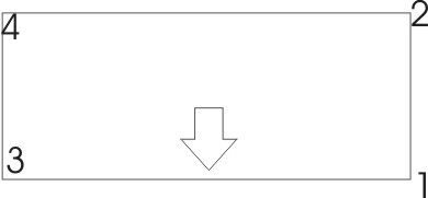

  • Chris Wool
    27 January 2012 at 23:39
    if any help my graphtec plotter finds marks in this order

    Thank you Chris
    I try thats order like yours but it is same
    in my Mutoh plotter When i choose mark 1 and when i click ok
    plotter go to next point automatically but Graphtec ????
    i dont know.. what is the wrong?
