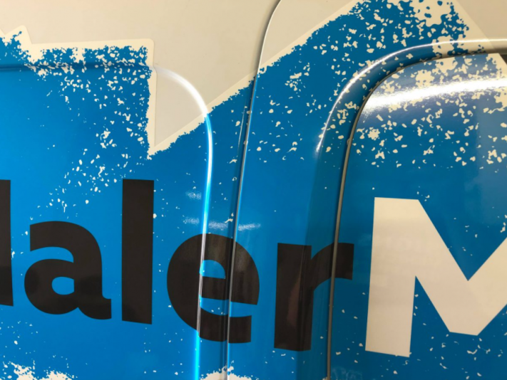

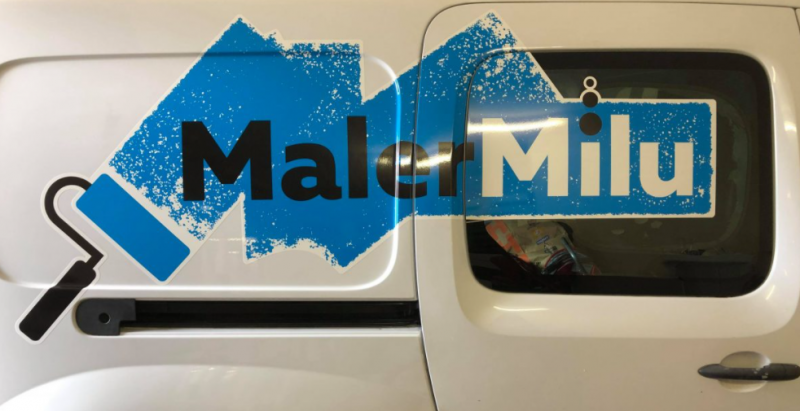

Posted by Pane Talev on 1 July 2021 at 08:59I did this Renault Kangoo with Arlon SLX.
1) Is Arlon SLX an overkill for this job?
2) Will you do it using different vinyl? (please state exact vinyl)
After burning my self using Metamark MetaWrap MD-X, and re-doing 3 Renault Masters, I decide to use premium film for all my work now. What is your opinion? Happy to hear it.

Overkill perhaps, but gives peace of mind I suppose.
Might up price and cost. But if you had 2 or 3m on a roll left for another job, then it would of been false economy to order in another 22.5m roll that’s of lesser grade.
Use the better vinyl. Call it insurance, or peace of mind, or whatever.
I use 3M wrap vinyl, mainly because its a brand customers have heard of, which makes it easier to sell. Avery, Arlon, Oracal, probably just as good technically, but they just dont have the brand recognition outside the sign industry. -
How much did this cost you to do Pane? Or how much would you have saved had you used your regular material? I doubt the saving would be worth the worry of it failing in the recess, but I’ll ask you this. Imagine pulling up alongside this van done by you on the cheap, failing in the recess & knowing it’s coming back for you to do the premium version completely free of charge. Wish you’d spent the extra 50 or 60 sheets? I don’t think we over specify these jobs, but I suspect you think you’ve undercharged them. If the material stays put, it’s the right one, don’t be in too much of a rush to give customers a BMW for Kia money.
Just my opinion mate, but have a wander round town, take a few pictures of failed vinyls on vans & show the customer when he gripes about how you’re charging a bit more than the bloke down the road. If he can’t see the light, scrape him off, he’s beyond redemption.
Personally I’d be reasonably confident using MD5 for that specific installation – provided it’s fed in, and under no tension.
It’s just catching part of the corner of the panel above the e, which would has me wondering, but I’ve not looked at the Kangoo recently to know for sure.
The cut around the window should allow it be fed in, around there.
As Simon and Kevin point out, if I had the SLX in stock, depending on the customer & price why not use it. Perhaps it is overkill, but you can sleep tight knowing it’s right.
I recalled a maxi mover the other week, stripped the entire side and re-wrapped it, as I’d got distracted when installing, and door catch landed smack bang in the middle of a word on one side – Wound me up like crazy, ruined my weekend! Customer didn’t really care but really rattled me.
I’d opt for a cast film on that all day long.
If you tried feeding in polymeric, the vinyl would distort, unless you applied heat and it would stretch likely failing.
I only feed in on straight steps not the corners.
Not sure how the fusion would handle it as I haven’t used it, perhaps some of these hybrid films would do the job – not worth buying a roll though if you had SLX in.

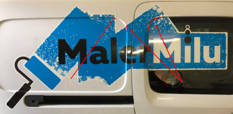

Hi Pane

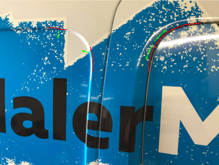

Your first photos show a side with a window and the graphics shape sort of allows the vinyl to be manipulated and folded in and out of the recess. depending on how it’s handled and fed/squeegeed, “you can” create a bit of slack naturally to allow less stress and tension on the vinyl areas shown in RED. The part with the glass would be cut against the glass edge and the rest worked down into the lower section. this creates tension but it’s more spread across the bend rather than pulling up out of the recess, so again the vinyl should cope with this easy enough. Arlon polymeric would come with this without any problems. -
However, the opposite side is a different story.

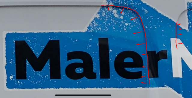

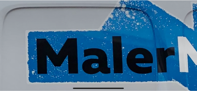

As you can see where indicated in RED. you have recessed tension all the way around the area on the left panel and part of the way on the right panel. so your not going to get away with feeding the vinyl into relieving tension. You could opt for Arlon 6000xrp which i would think is a more cost-effective approach than the SLX. -
DPF 6000XRP – data sheet attached
Premium Cast Multi-Purpose Film With X-Scape Technology -
