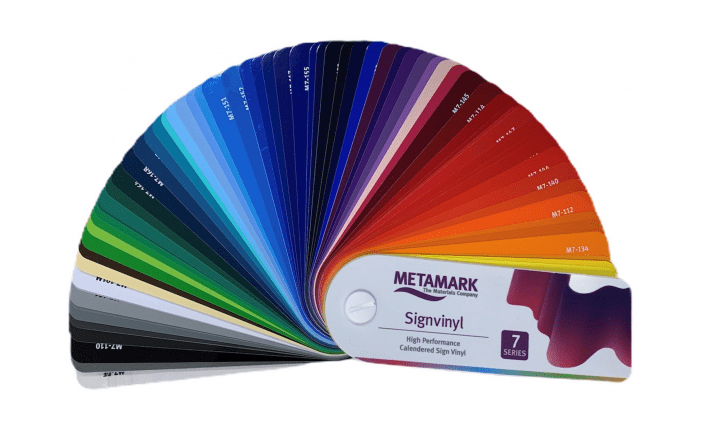

Posted by Pane Talev on 4 May 2022 at 15:40I have reasons to believe that standard CUT vinyl Metamark M7 Series performs better than M7A MetaScape, thoughts please?
