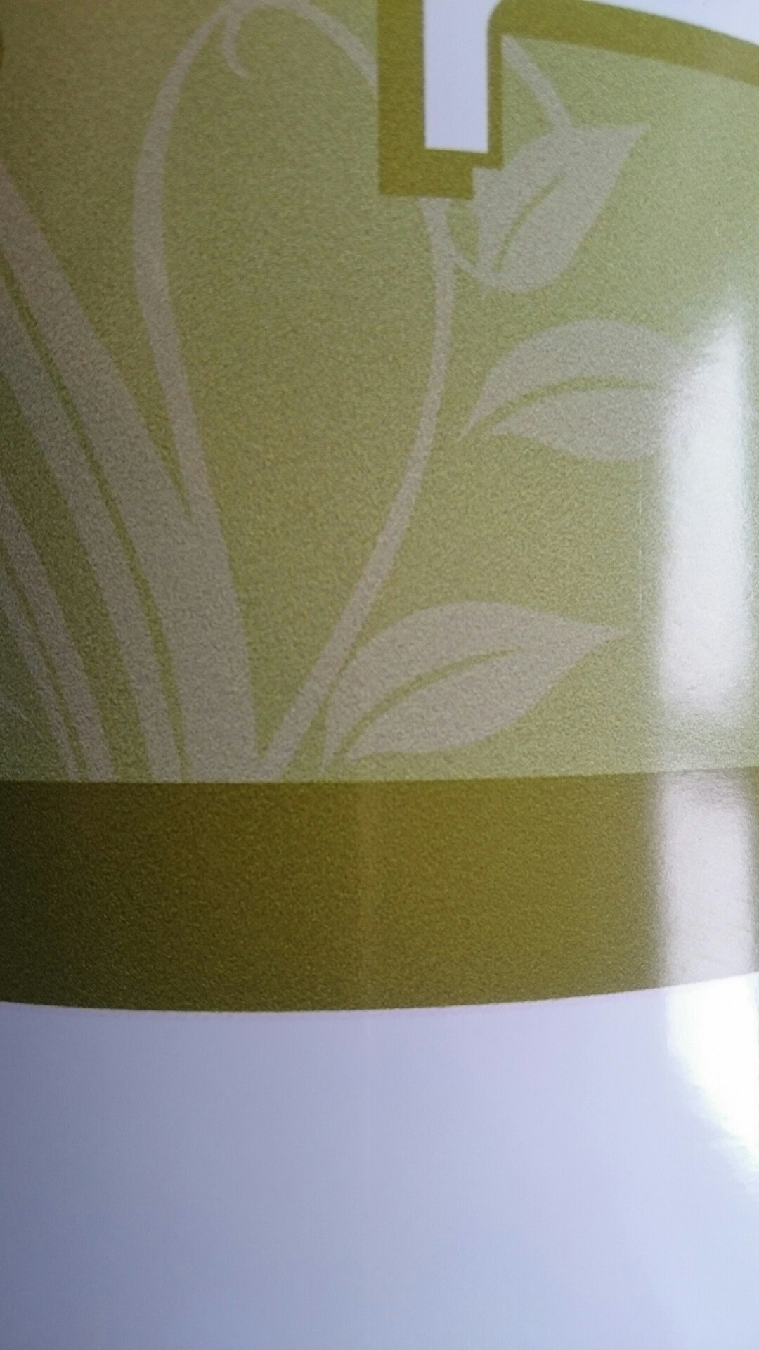

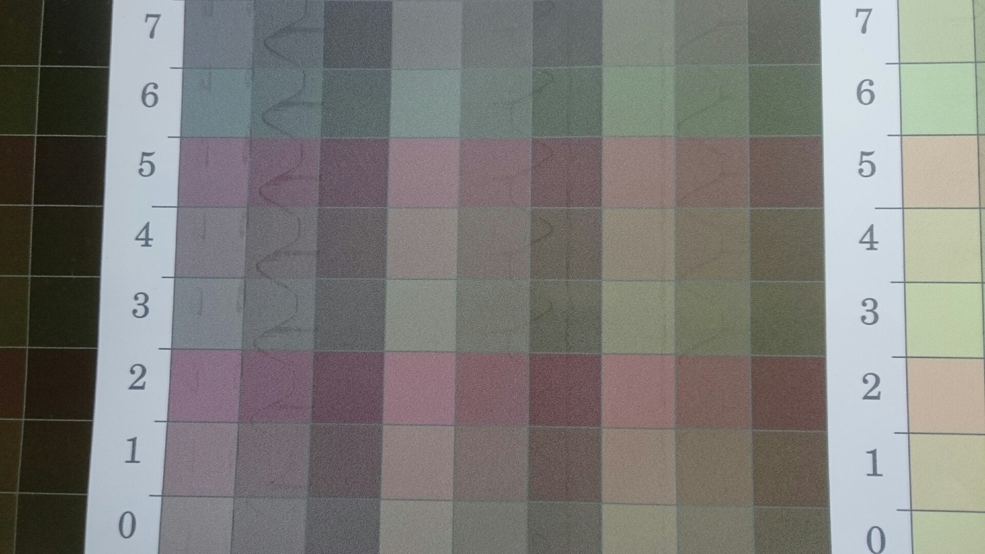

    Hi All, Wonder if anyone has had a similar problem to this & know what the cause is. It only seems to happen on the Avery 2803 in my limited experience so far. I am getting wavy lines produced by the pinch rollers. I have taken them off previously & cleaned them all individually with 90% isopropanol mix & they don’t appear to be dirty. It is only on certain rollers & not over the full width of the print area. It tends to be the left-hand half & varies in intensity. It does seem to resolve after a metre or so of printing but returns again at the start of the next print run the next time I use the same vinyl.
    Any ideas?

    You sure it was wavy lines like this Peter? These are definitely caused by the pinch rollers as the pattern exactly matches the pattern on the rollers. I do actually have 1 head that’s out of warranty although it’s still used under 1000ml & I can’t see how the head would relate to the marks. & like mentioned why would it only occur on certain media & not all?

    Run out 1m amount from the front of machine and stop before it hits the floor, wipe over vinyl with iso and allow to dry for a couple minutes then rewind and try printing on it again, if the problem improves or goes away then its due to an old batch of product where the plasticiser has gone off. It normally happens a lot with Banners more than vinyl as people keep it in stock so long and it goes off over time, there is a hp latex support vid on youtube about it.
    Might not be the answer but worth trying anyway.

    Very interesting Kevin. Just watched the Youtube clip. Shame he didn’t have an actual sample & had to draw the lines on in marker!! : lol: But yes it seems very similar. Only thing is my roll is dated this year so it’s definitely not an age thing. Possibly poor storage at some stage?? The odd thing is it’s only on the first maybe 500 – 1000mm.
    I went into the service menu yesterday & you can set the main rollers to rotate for a few mins with the window up & I gave them & pinch wheels all a good clean again with degreaser. Nothing notably came off & I then ran about 12m of Avery 3001 through with no sign of a single wavy line!! Then changed rolls to the 2803 whilst printer still warm etc. & ran a test print. There were a couple of much fainter wavy lines again but only for about 3-400mm & then they went. I continued printing another 15m run on the 2803 without a hitch. So still a bit of a mystery to be honest.
    Only got about 9m left now so will be interesting to see if the same happens again with a new roll.

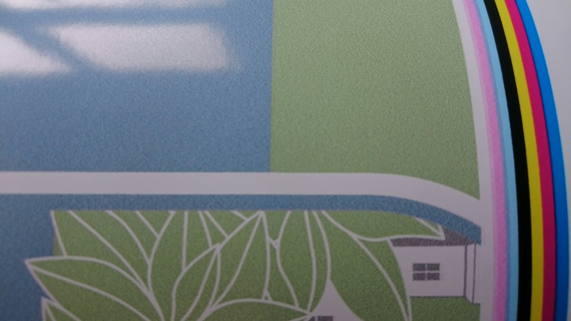

    Just another quick question, I’m finding that I’m getting a bit of graininess (is that a word?) in solid colours when printing onto the 2803 which I don’t get on the cheaper media. Using similar settings i.e. 10 pass low ink which gives excellent results on the cheaper media. Any idea what’s the best way to improve this? It’s only obvious close up but I’d like to improve it if possible.

    That’s my point! If it was dirt it would be obvious. I think Kevin has it with the plasticiser, but why it should only do it on the first 500mm approx beats me. I printed another 5m on Aslan DFP 25 White & 41 clear this morning & not a sign of wavy lines!

    I think it happens at the start more because that piece has been exposed more than whats covered inside, I used to get round it by printing a 500mm strip of the design before printing the real design, with a little tweaking you can then get the design printed without the marks.
    Dates on batches are very unreliable as they might have taken months to get the the supplier plus it could depend on where the media was stored in the container on the ship, at the top it gets all the heat from the sun, down below its very cold, was surprised how many things make a difference to the end result.
    Its not something I get much problem with now especially on the 310 newer inks but the worst culprit for me was outdoor banners, I went through every banner material supplier had and all had the same problem, switched supplier and problem gone so its amazing how long some suppliers keep stock beyond their shelf life.

    With regards to your ‘graining issue’, I was getting the same thing in the blue parts of my prints. New C/LC printheads sorted them out, even though the old printheads that were fitted had only fired less than 400ml each and were both in warranty.
    Think I might have to try that Peter. I know that one of the heads is out of warranty anyway. Out of interest were you able to make a claim under the warranty on them?
