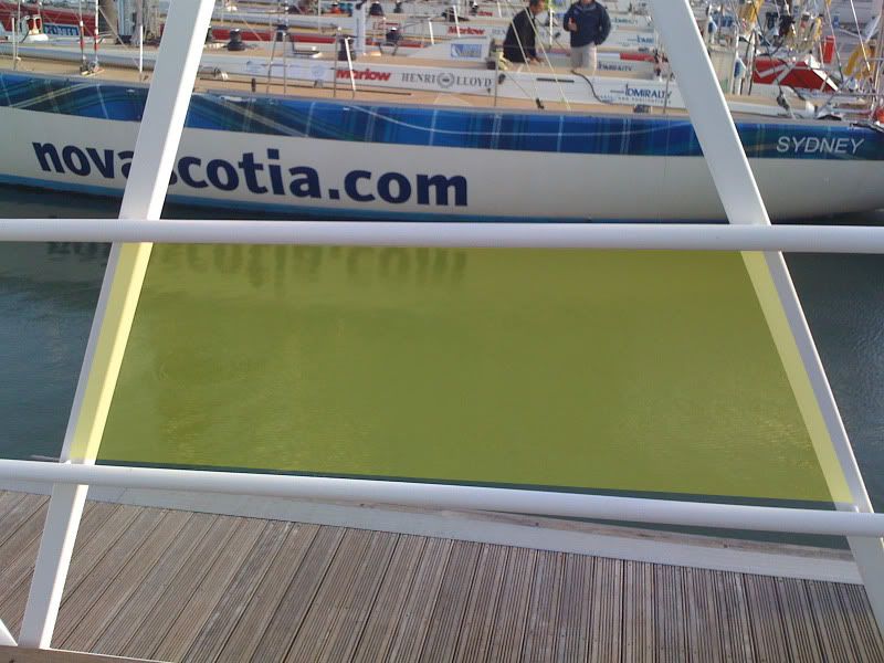

Posted by Warren Beard on 12 November 2008 at 10:38Hi Guys
I have an enquiry to fit an advertising board to this railing into the middle section as shown. It has to be double sided too.
What material would be best (for 18 months) wet and windy conditions.
How would you fix it without drilling/damaging the railings?

Thanks guys but I forgot to mention they don’t want banners 😳 🙄
They want it to look better than banner so have asked me to advise on material and fitting. They will be up for 18 months and need to be kept looking good.
Karl they won’t let me drill in to the railing and need to fix it another way.
I was thinking of oversizing a dibond panel width ways with a square wrap around bracket and pop rivet it through the dibond on to the bracket (if you know what I mean)
cheers
Warren

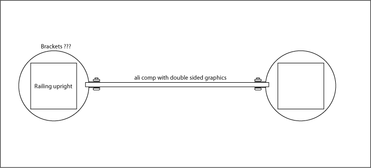

what about this idea? can you get these sort of brackets or would I have to get something made up? I would put some rubber between the bracket and rail to stop it scratching.
Not sure I want to have to repaint after removal of VHB tape.
just a thought! suggestions welcome.
Warren, give me a phone when you can, are they after permanent advertising or is this for use in port only. This looks more like a racing yacht therefore are they to be removed while in use?
You can get ‘P’ clips with integral rubber off the shelf in a plethora of sizes, most auto factors will stock them. Fittings WILL have to be A2 stainless as a minimum with a preference for A4. Aluminum and salt water don’t get on well together and the panels may start looking tatty before the 18 months are up…….stainless panels for longevity or 10mm foamex and replace a couple of times!!!!
