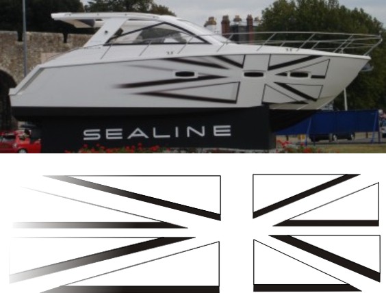

    Hi all
    looking for a bit of advice please, a customer has seen this boat & wants the same Union Jack on his. How would i go about creating this?
    the solid black part isn’t a problem I can draw that easy enough, the faded part is where I am struggling. Software wise I have Photoshop CS2 and CorelDraw 12.
    Also once created I was thinking of printing the faded part on to clear wrapping vinyl & laminating would this last when the boat is in the water?
    The other part would be black cut vinyl.
    Any ideas would be much appreciated
    thanks
    Neill

  • Phil Halling
    30 October 2007 at 18:03
    Saw this boat today in kidderminster and yes the faded section is printed on clear and should be laminated with a film laminate not liquid lam.
    Phil
  • Steve Underhill
    30 October 2007 at 18:49
    In photoshop either use the eraser tool at varying degrees of opacity, or use a selection tool and then, select, modify, feather until you get it right.
  • Chris Windebank
    31 October 2007 at 08:55
    Hi Neill, made a quick start, have the AI file here if you need it

  • Steve Underhill
    31 October 2007 at 09:48
    With that design being square, and the design on the boat curved to the shape of the hull you might have to alter it to avoid wrinkling.
