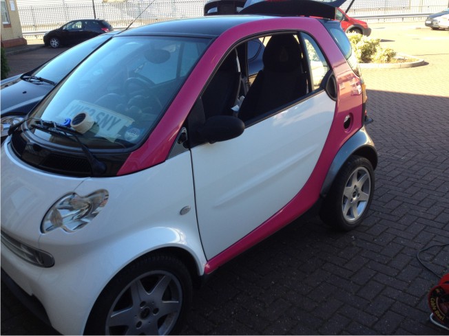

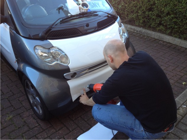

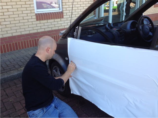

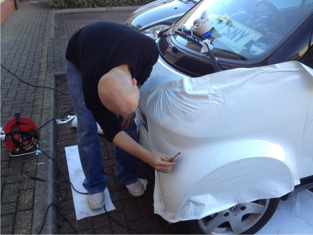

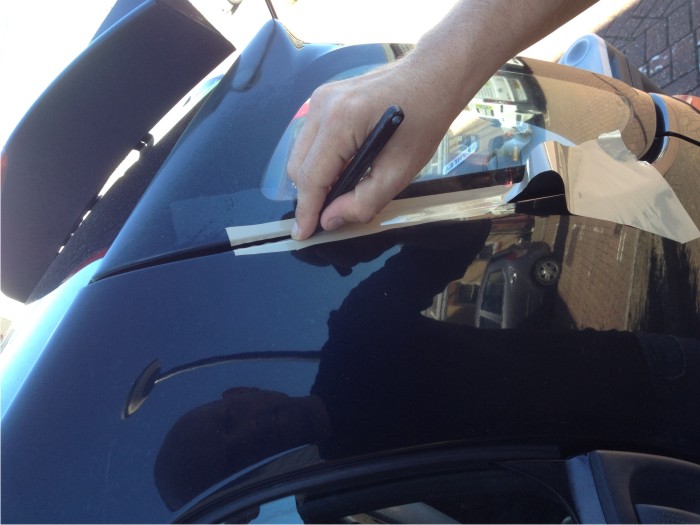

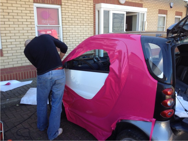

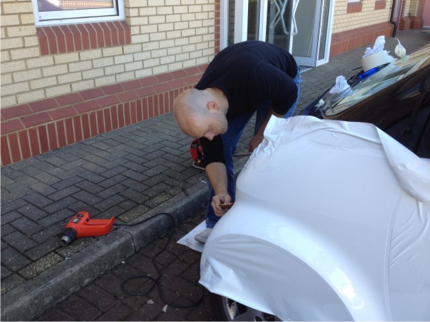

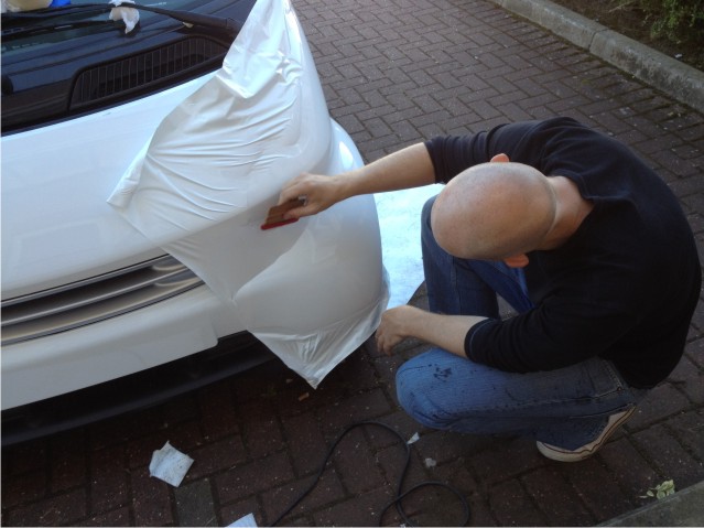

  • Chris Windebank
    7 September 2012 at 16:49
    Daniel sorted out how to cut his graphics and managed to do half a smart car in 2 hours. Took some photos as he went
