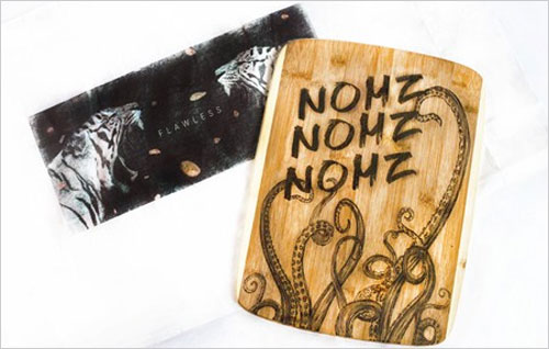

    The solvent image-transfer process involves “borrowing” subject matter from printed material, chemically dissolving it and transferring the image onto a new surface. We’ll be applying the image transfer to canvas tote bags and wood cutting boards, but you can take it a step further and try it on different objects of your choice with the same mediums and materials.

    Print out a mirrored/reverse version of your image at the desired size. It helps if your image is darker and more saturated, so the ink transfers more successfully. You must use a laser printer, which is important because of the toner-based ink. Inkjet printer ink may bleed too much.
    When you’re ready to begin the transfer, be sure to work in a well-ventilated area. Lay your print image side down on the fabric or wood surface you’ve chosen. Tape a side down, if needed, to keep it in place so it doesn’t shift during the process. Use a cotton ball or brush and saturate the backside of the print with acetone.
    Step 2
    With the card, rub back and forth over the backside of the print. Use even pressure and be careful — too much pressure may rip your print. The ink transfers better when the area you’re burnishing is saturated with acetone, so you may need to re-saturate if the acetone starts to dry out. Making sure it’s saturated while immediately burnishing the print is important, because it will create a crisper transfer. If you need to work in smaller sections, it may also help if the print is big. Try practicing on some paper, scrap fabric or wood to get the hang of it first.
    Step 3
    Carefully peel back a bit to check on the transfer, and to see if you need to burnish more. If it’s to your satisfaction, peel away the entire printed paper to reveal your transferred image.
    Step 4
    If you’re transferring onto fabric, toss the fabric with the transferred image into the dryer for 10 to 15 minutes once it’s done. The heat will allow the ink settle into the fabric.
    If you’re transferring onto wood, seal it with a clear coat spray. Make sure the spray you use is safe for surfaces you plan to use for anything edible.
