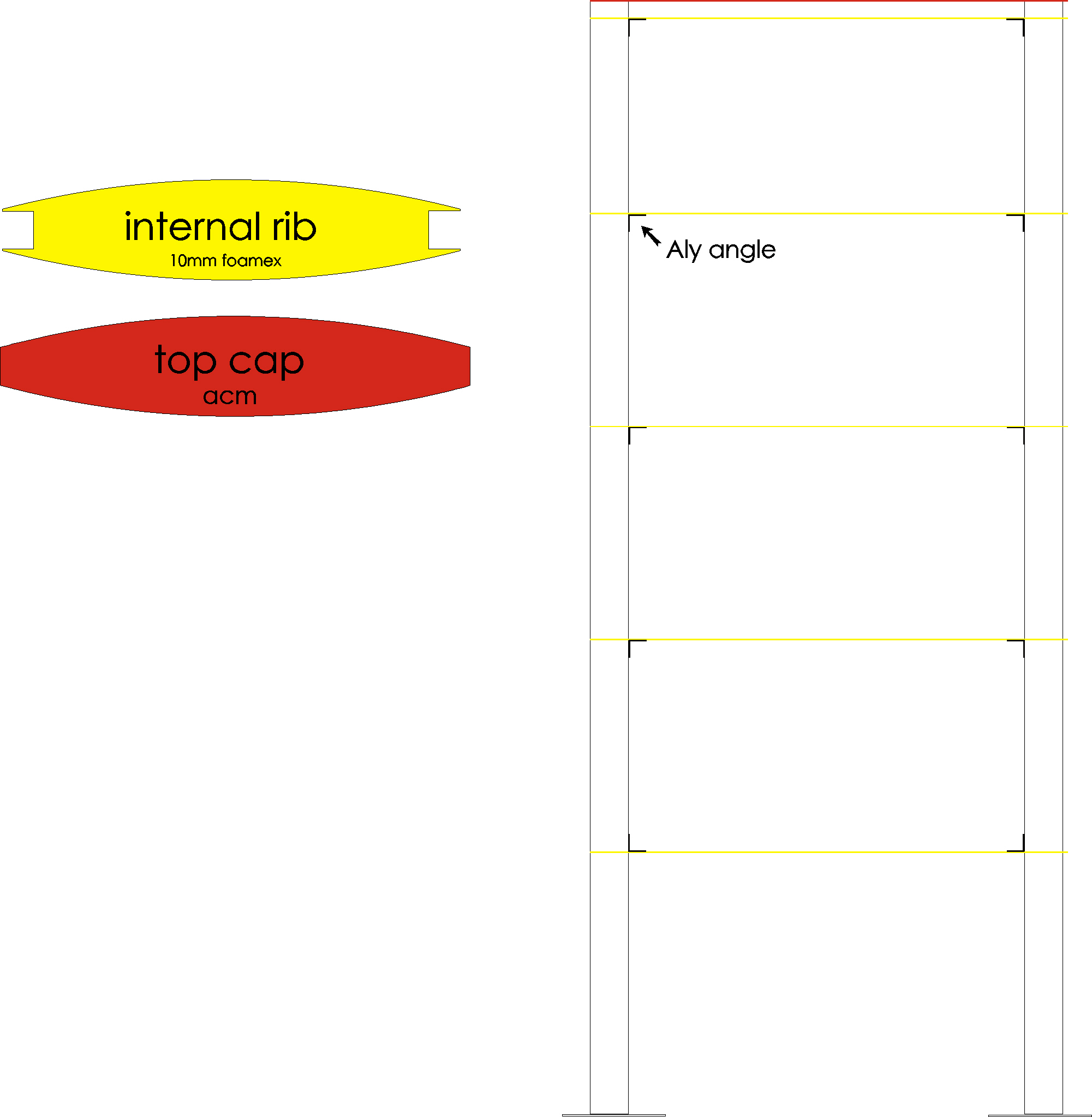

    4 August 2011 at 22:14
    more or less the same as a standard totem, only use 10 mm foamex ribs to shape
    rough principle shown,
    make sure you ribs are correctly aligned, and the ACM will pull around the face easily enough,

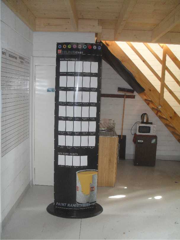

    I’m busy doing a truckload of these at the moment. It is a Country-wide contract for the biggest paint manufacturer in Namibia.
    I just make the frame (in this case aluminium square tubing) a bit narrower than the panel (2mm abs) – That forces the panel out in a curve.
    With Dibond you may have to roll the panels. Take them to a sheetmetal workshop to run through their rolers

    Nice sign Gert!
