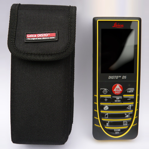

    As mentioned earlier but also use a Disto D5 laser which can measure height & width of a sign 4 storeys high or more and is certainly accurate enough for a quote.

    Hi Peter Dee
    I’ve never come across the Leica Disto before but looking at their website it appears to be an excellent tool.
    Please can you give some more comment on how easy it is to use, accuracy, any other salient points etc.
    Is the 45 degree angle limit an issue? Is it worth looking at the hugely expensive D8 with the full 360 degrees?

    7 March 2012 at 09:11
    quote David McDonald:
    Hi Peter Dee
    Macky
    David, this is one of those tools that sees daylight once in a while but is worth its weight in gold when used.
    Recent scenarios;
    I had to hang acrylic signs spaced at certain intervals over a restaurant counter. The client indicated each point and I just flashed the laser at an end pillar and instantly had my measurements, accurate to less than 1mm.
    I had to quote for replacing a sign at the top of a 12metre building. With the D5 I was able to measure the existing sign pretty closely for height and width, plus height above ground. For this I used the included package tripod.
    This took around ten minutes and combined with scaling a photograph with some key points made for a realistic visual overlay with measurements good enough to quote from.
    Another good feature is the built in angle readout which can give you dead level readings. The 45 degree limit has never been a problem and as I don’t need blue-tooth connect-ability the D8 was not worth the extra.
    The D5 is also great for measuring the height of a fascia etc above ground; no more steel rules blowing in the wind!
    You can also set this to constant readouts so you can move the unit to a point until the display gives the required distance.
    I recently had to measure a fascia in the freezing cold and dark and forgot the laser. I had to use a tape and move the ladder 4 times adding up the distances. Would have taken seconds with the D5.
    Now the thing about this model is that it is the first in the range that is designed for outside use, and combined with the zoomable on screen targeting is just superb. You can find its predecessor the A5 on ebay sometimes selling for around £160.
    I got it from here http://www.laser-measure.co.uk/ and they are very knowledgeable and helpful.
  • David McDonald
    7 March 2012 at 09:43
    Hi Peter
    Thank you for taking time to give that info.
    Think I will order one.

    Hey Peter how accurate do you find the Distro from using it to measure to getting real world measurements?
    I’d like to get one for my brother so he can measure things from the ground.

    I won’t be using it. Its for my brother so when his on site doing a site survey he can accurately measure what he needs to from the ground. Saves someone else going to the side with a ladder and measuring it up properly.
    Most stuff we do is SAV so we can add bleeds and adjust on site when fitting.
    For comp panel signs etc we do the same but if it needs to be perfect I guess we can quote it then go back and accurately measure.
    $500 is a cheap investment to save one stuff up getting the size wrong.
  • Peter Dee
    9 March 2012 at 14:12
    Jason, I’ll know for sure at the end of March when we have to take down some very high signs which have been pre-measured by laser.
    It works by using Pythagoras angle calculations.

    I have just purchased a Leica Disto d5, I am sure it will be a very useful tool, will let you know how it measures up !

    I know this was posted a while back, but anyway, the Leica d5 uses double Pythagoras, or the button pressed twice to give you the measurement, which is done by taking three points to work out the width, it has to be used with a tripod to get it spot on, and also a bit of practice, but when you get the hang of it deadly accurate, list price looks pricey but it is a lot cheaper on auction sites, used it several times for hard to reach or up too high for traditional tape measures, saves a lot of grief and time, you tube have a few clips demos.

    One of the companies we use to install our signs has let us down. I need to measure a long sign that’s on the side of a warehouse, it’s not a job I fancy on ladders and I’m not hiring a cherry picker for a day to measure it.
    Looking at the Disto X310 due to budget.
    How accurate do you find its measurements?
  • Graham Shand
    2 June 2014 at 18:51
    Using the double pye feature, very accurate, use a tripod and it will be spot on, there are a couple of you tube video demos
    2 June 2014 at 19:03
    Excellent!
    Is the tripod anything special, I’ve 3 photography tripods, so I might just need an adaptor for it to attach to?
    Now do I get the 80m or 120m range one?
