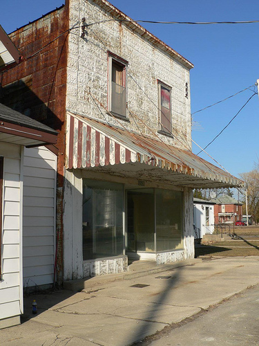

    I know this should be in the sign topics, but I couldn’t post the picture there and I thought it would be helpful.
    There is a problem that surfaces for me from time to time, and I usually end up turning down the job.
    How do you get to the wall over an awning to put a sign on a wall above the awning? I can’t use an extension ladder, an a frame ladder or a scaffold and still reach the wall directly above the awning. If you were to put a sign in between the two windows above the awning in the photograph (photo is one I found for discussion purposes only, not the actual place), and you could not remove the awning, how would you go about it.

    I’ve seen the place in person now, and it has a faux facade made of canvas stretched on a frame above the awning, and it’s removable. It’s 17 ft long by 6 ft wide, they are going to take it down and I’ll paint it in their back hallway and then they’ll put it back up.

    Brian, yes, the pic looks like it should have some horses hitched out front – that’s not my client, though, far from it – that’s a pic I found on Google images that illustrated my dilemma reaching the wall. The place in the pic looks like a place who’s time may have passed.
