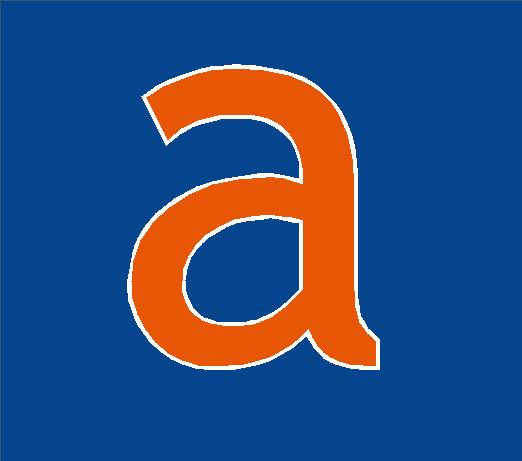

    11 December 2005 at 20:32
    Thanks for the tip Jill, I’m not quite sure what you mean though,
    On the picture the white and blue is the paint mask? the a is painted, so which bit and when do I remove?
    11 December 2005 at 21:27
    You would cut the letter with the outline, but NOT weed out the outline.
    In this example the orange A would be the painted portion,
    the white outline would be the part the you’d remove shortly after painting, when the 1-Shot starts to set up.
    Do you understand?
    The letter itself, when finished, would just be the orange “a”.
    The outline removal just helps the paint to flow out naturally,
    so that it doesn’t dry with a sharp edge.
    11 December 2005 at 21:29
    Thanks Jill, that makes sense now,
    Cheers,
