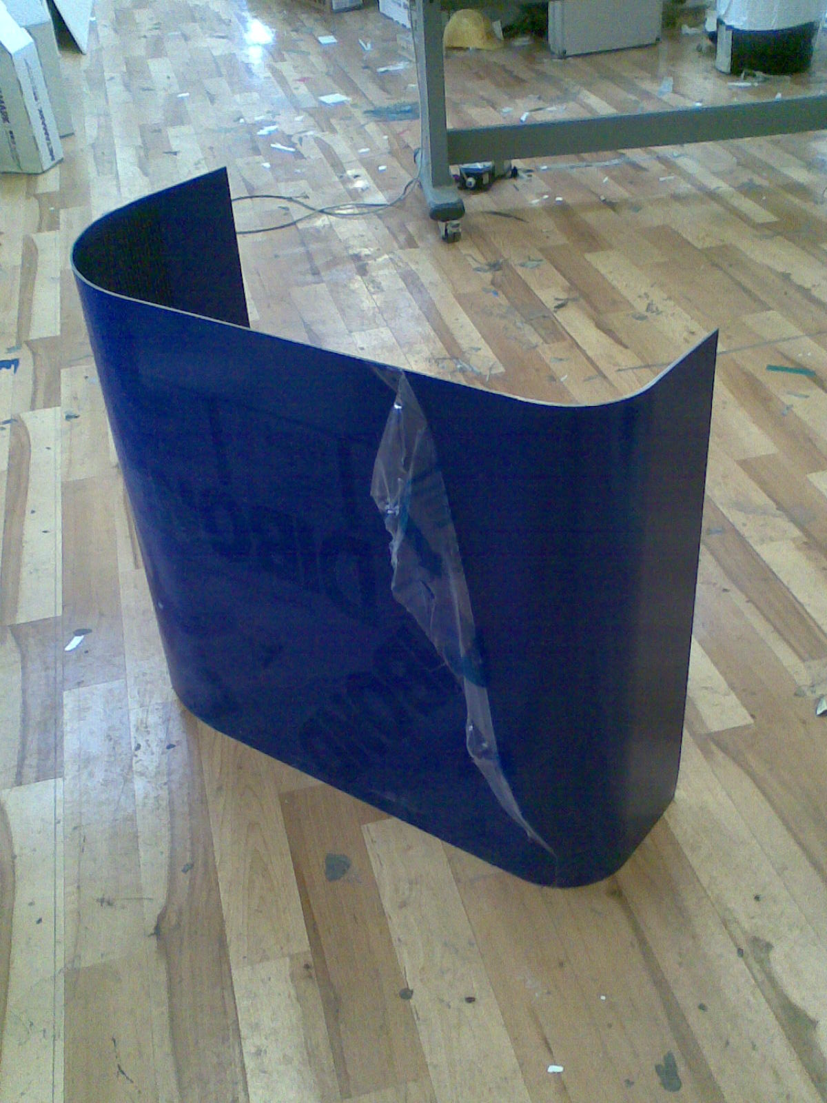

we are doing similar at the moment, my usual guy i use for rolling has decided he only does his own stuff now so had to come up with a different idea.
it worked a treat,

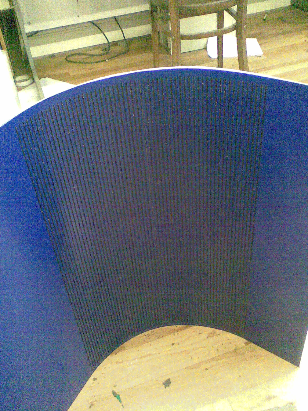

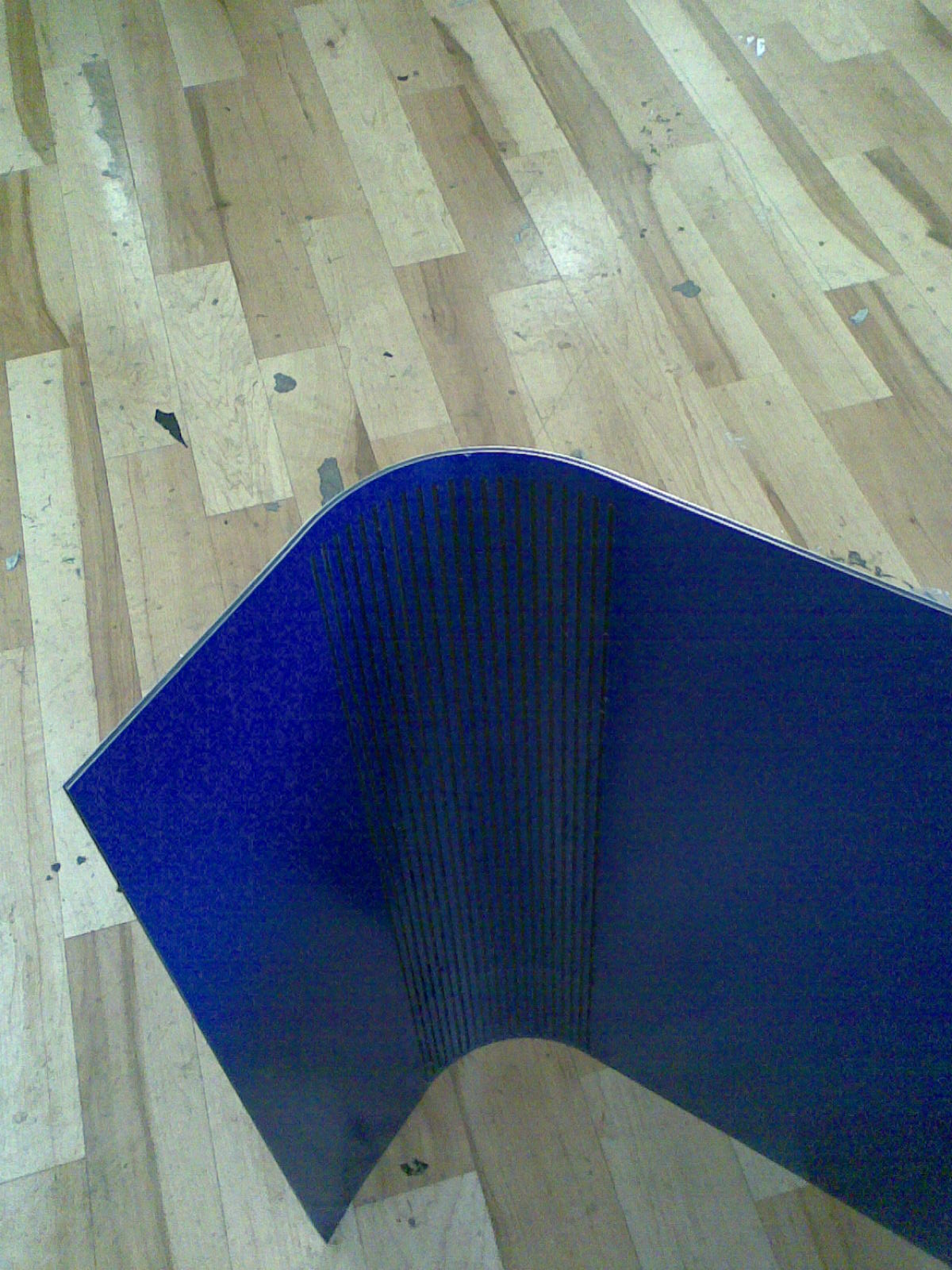

get someone with a cnc to router out a stripe pattern with a 3mm bit on the back of 3mm dibond, with gaps of 5mm between the router tracks, taking only the aluminum and 0.5 mm of the core on the router pass, doing a test we found if you leave a small bit unroutered it holds it shape perfectly.
i was able to easily form a 89mm radius and a 300mm radius by hand on the sheet and it held it’s curve no problem.Ian

i used the principle of bendy MDF, decided to see if it would work on dibond and was mightily impressed with how it worked.
the pillar we are doing is 4meters high by 2.2m. not finished yet but will post the pictures.
I have done the force method before of bending it around a shape but unless you have a fold at the finishing and starting edges it is inclined to pull a lot on the fixings and bow out under pressure. this way you can rely entirely on glue fixing .Ian
