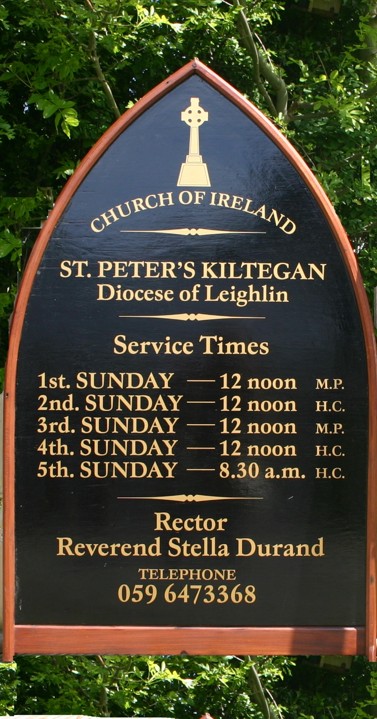

    The other day, I had local guy who dabbles a bit with lettering come to me with a job for local church, normally he would brush whatever, but this one was too intricate for him to handle. Client had requested gold lettering in Times Roman or similar.
    Unless you set and cut the copy in vinyl you will have to make a pounce pattern which depending on size of lettering/serifs could be difficult and then apply colour. Have never used markers, but would imagine that serifs etc. could be tricky.
    My advise is to go the vinyl route
    Attached is what I did for him
    Pat

    Pat, that looks lovely and very non-computery.
