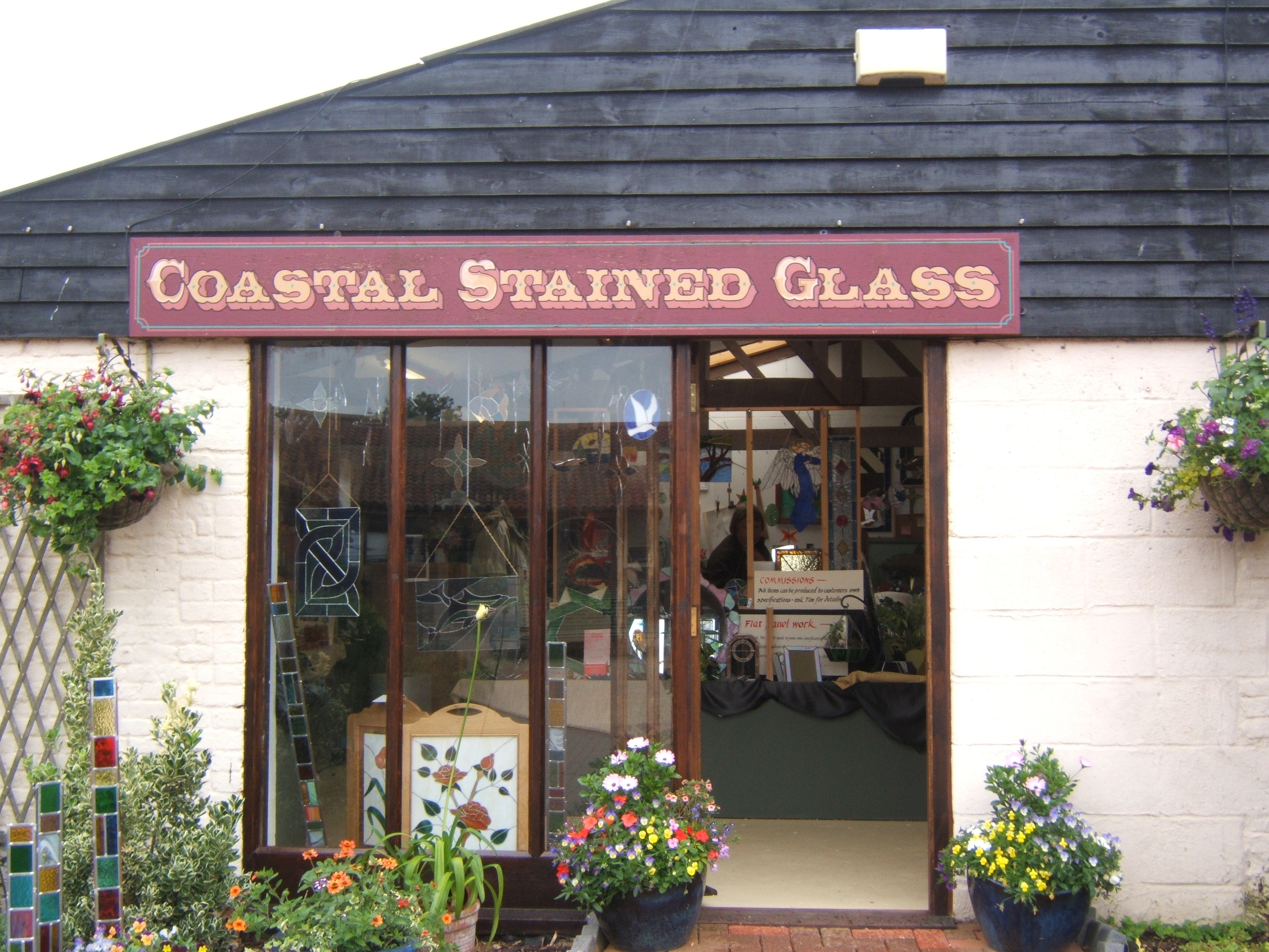

    The customer has a craft shop making goods using coloured glass & lead, finished results a bit like Tiffany designs.
    I have in mind to print a design onto clear vinyl, lay that on edge-polished perspex then finish the design with leadwork (or the customer will!)
    My query is, does anyone recall where to find the post made – I think – by Andy Gorman (sorry if I’m wrong here) when he made a stained glass window. I’ve just reviewed Robs ‘Subway’ demo, now looking for other ideas.

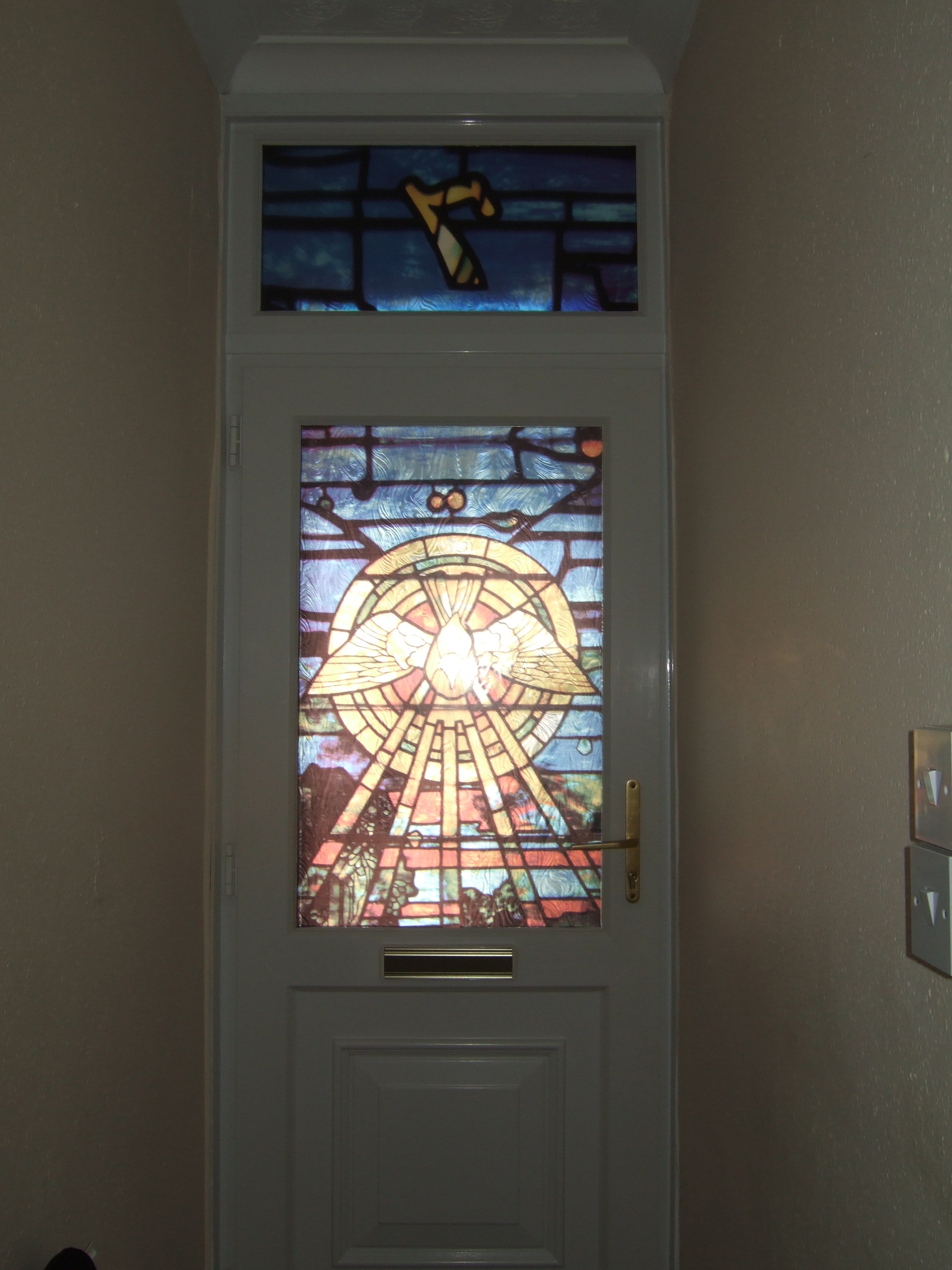

    I did this on my front door, scanned a christmas card onto clear. Dont know about actual leadwork…would be interested tho.

    I remember your posts about the windows you did, they are lovely, but I was after ideas which are slightly less complicated. I am going near to where the customer is in a while, so shall pop in with some ideas for him, and perkaps ask him to design the sign himself. (-)
    This is what he wants replaced…
