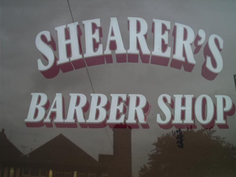

    Hi this is going to be my very first paid job,, the client wants this writing exactly the same on his other three windows but i dont know how to get this 3d effect can any one steer me in the right direction ive searched everywhere, sorry to be a complete newb

    There are a number of ways of recreating the 3d effect you have shown here.
    The cheapest and easiest is to use red and blue filters. You simply recreate the left eye view using red vinyl – and recreate the right eye view using blue vinyl. The effect can then be seen by anyone wearing a set of spectacles that feature red and blue lenses to decode the artwork.
    Similarly – the same can be achieved using polarised lenses. These separate the viewed images into horizontal and vertical polarized light. When viewed with a special set of polarized lense spectacles the effect can then be seen.
    A third method is to use a lenticular system which avoids the need for specialised 3d spectacles as this can be seen by anyone without any spectacle augmentation. However, this is very specialised and uses complex software which is perhaps beyond the scope of the average signmaker – so I would stick with red and blue filters to achieve this effect.
    I hope this helps 😀
    26 April 2005 at 22:50
    In whatever program, type out & arch your text.
    Copy & paste the same.
    Place it just below your text.
    Then outline the original text a wee bit.
    You will need to group the outline with the copied & pasted part.
    Then trim it so that it is offset from the original.
    Or, do what I do.
    Make the main text in vinyl and hand-paint the drop shadow.
    EASY!
    And much cheaper. Paint scrapes off a window the same as vinyl does.

    the font looks quite easy to do, not sure how to do the sillouette of the trees and houses though!

    The top shadows dont reflect the bottom ones anyway. The P should have the shadow on the left as the top has.
    Just imagine a vanishing point and direct all shadows to it.

    Seriously though, to create a shadow, first type in the required lettering, select it and look for the shadow option in your software ( depends on which software you are using, I use Flexi, so will describe it using that software) You should have a variety of shadow option to choose from, such as block, perspective, drop shadow etc. Select the one you want and adjust it to suit either by typing in values in the x & y boxes or by pulling it around by the handles on screen, click ok or the tick box and hey presto you have a shadow.

    Goop I have noticed that when you arch text the shadow moves to the other side.

    hi thanks for the replies guys, i will have a go at what you suggested Jem as i have flexi on my system its just all too new to me at the mo but with this boards help i reckon i can get there, iam not sure what rightsigns answer is all about though maybe he likes a drink my ex girlfriends dad was Scottish and he did.

    Brilliant Jem it worked a treat thanks but iam having trouble arching the text in flexi (just spent 2 hours trying) could you point me in the direction of this probably ever so simple task

    Hi cancel the above cry for help ive just found it at last 🙂
