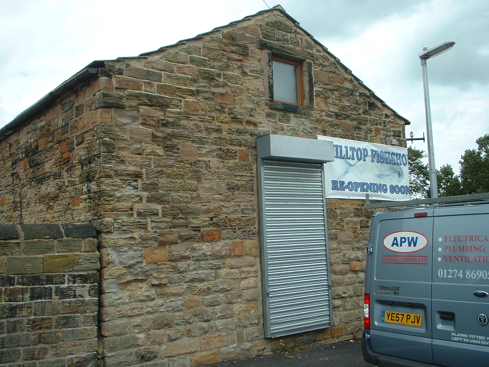

    hi all, can anyone help with suggestions on how to best fit a flat dibond panel to an exterior wall that is a little unlevel…see pic..
    any help and advice appreciated

    dont fit a flat panel fit a tray. some 2×2 batton, 50mm fold on the dibond.
    you’ll never notice the surface

    hi, thanks for the reply, that was my way of thinking…
