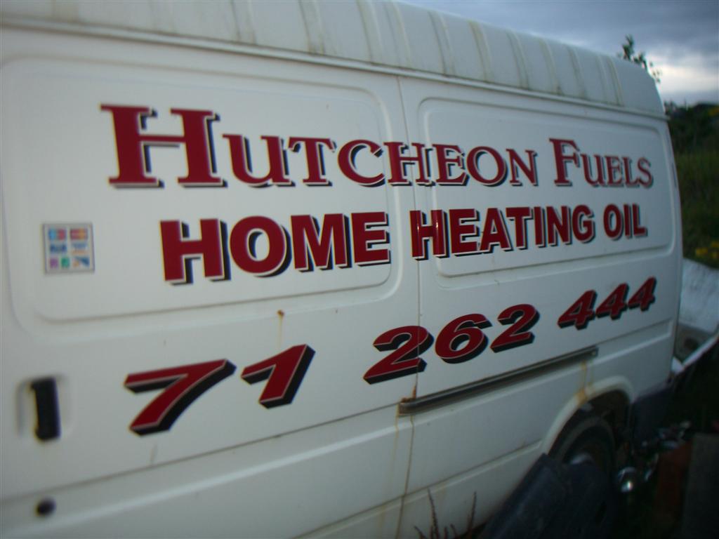

    Hi folks , got the job of re creating this onto this guys new van. I have done a bit of research on the boards on Shadow effects, can do a few different shadow effects but struggling with getting the gap between the layers using x3. I could change it to a way i have been able to do it but a better match would please him more as his two lorries are the same, Also he is getting the lorries resprayed to a new color scheme so if i get this correct i will get that job also.
    1. make 3 copies
    2. contour out in different colour
    3.break apart
    4. weld two together
    5. Place original back on top
    6. trim out what you don’t want
    7. both layers are beside each other
    8. No space between each?
    Do i need to add a contour and keep it and delete the two welded parts ?
    Thanks Tim

    that shadow was created in sl or similar not coral, due to the angle of ends.
    type text at full size
    create a contour path 5 or 6 or 7 mm outside
    separate new path from lettering but do not move it
    duplicate new path and move to required position
    trim the first path from the duplicate
    and cut it.
    chris

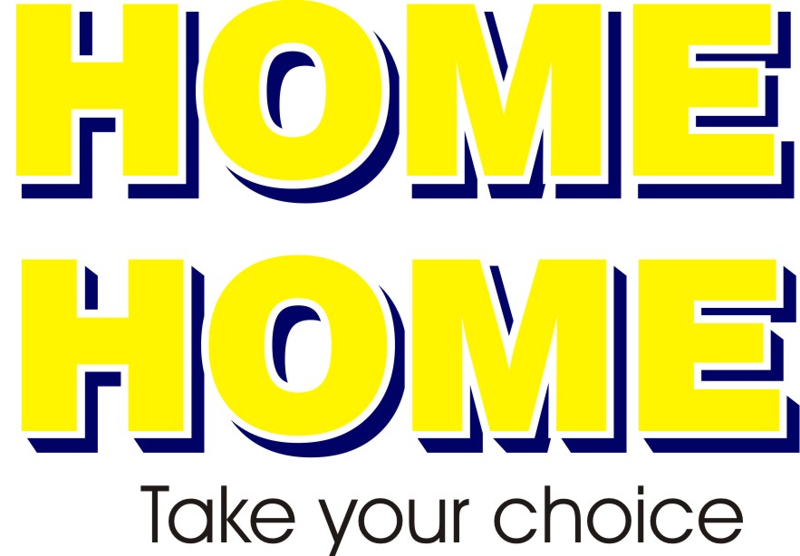

    Thanks everyone got it sorted, Have been able to do the top design ( Home ) still working on the second. Have also updated it a little and changed the black to light Grey to try and convince him to change. And also only shadowed the name only .
