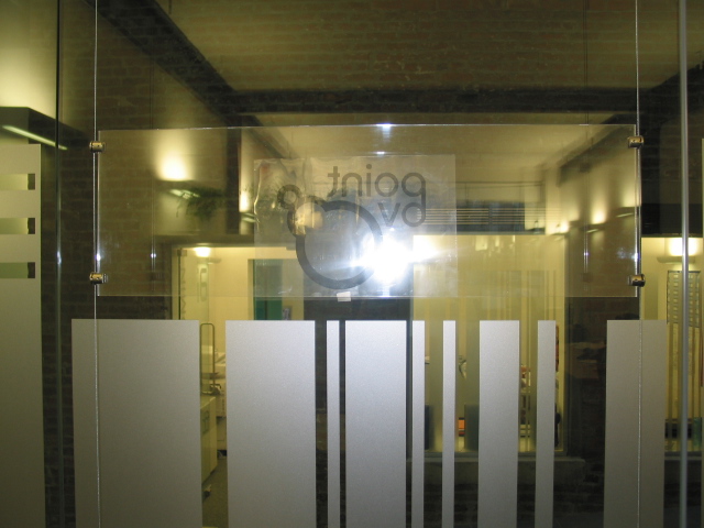

    morning all i have the following job to do remove old graphic as you can see from photo it looks like it is printed onto square sheet what is the best thing to clean with after removal i am told it is perspex sheet
    i am worried about marking it graphic to go back on in black wet or Dry ?
    as i have to do it on site any advice appreciated

    Benziene is good , as is meths if there are significant gum deposits – benziene is a little nasty as prolonged exposure leads to cancer , meths is problematic if the pex is stressed from flame polishing as it can lead to stess cracks, If there is NO gum left after stripping , then use warm soapy water.

    Only looks like a small panel Dex, why not save yourself the grief and just sell them a new panel complete ?
    Failing this, I use either white spirit or Rapidtac adhesive remover but as the others have said, be careful of polished edges causing crazing.

    would love to do a new panel but i think it would cost out too much simpler to replace the graphic i have quoted £50 which i think is reasonable not too much so i can get a foot in the door new customer
    i am very wary of cleaners we used a one at work for years i think it was caled MEK supposed to be safe 😮 we have a citrouse based cleaner at the minuite calld citosol removes glue from metal etc but will remove paint and anything else basicly paint stripper but smells like oranges 45 is there anything specificaly for perspex (if thats what it is ) i will give them a ring and see if a spec sheet is available they will probably reply 😮 what thanks again

    If you are sure it is perspex and not polycarb then just use cellulose thinners, cleans and degreases at the same time.

    We use the Citrus based stuff. Got to watch it doesn’t have an adverse reaction to the perspex as it does with some plastics. i.e melting.
