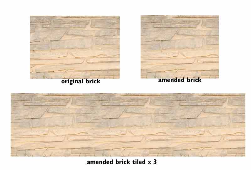

    you could try a photoshop plugin demo from flaming pear called tesselation – the demo is free for a couple of weeks after download I think and is not too expensive (http://www.flamingpear.com/tesselation.html).
    This does some of the blending for you (you can blend ends only – which is I guess what you need – or top and bottom as well). Its not always suitable but for repetitive and regular brickwork should hopefully be ok for your needs. You will need to select the area you want to copy, go to ‘filters’/flaming pear/tesselation and follow instructions etc., then join two or three copies of the altered ’tile’ together.
    Will try to attach a picture to show you (perhaps not the best example as not too uniform and there are JPEG artifacts from reducing file size).
    If you want me to have a go PM me the file and will try to get back this w/end.
