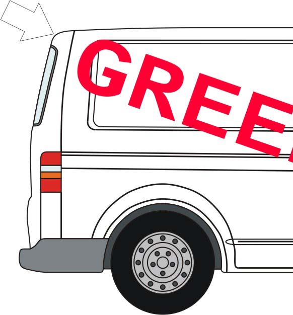

    Qick update first. I mainly do private estate agent boards so easy applying methods to date. I have a van to do, Real simple text from top left to bottom right, Large lettering, No numbers or anything else.
    My problem is Top left of back/side of van has the recesed panel area to start, Customer wants it right up to the top left to start so it covers the recess horizontal and virticle including the curve bit.
    Would you apply it flat over the whole area, Then apply heat to recess bits slowly pushing it down in place?

    You got it right in your post, apply to flat surface and then heat in to the recess. It’s not that easy if you have never done it before but you have to learn sometime 😕

    Steve, you could get 651 to fit into the recesses by heating with out to much of a problem but as its a calendered vinyl it will try to return to its original shape so will probably pull its self out of the recess at some point in the future. I have had guys come to me for a quote and got the job done cheaper else where only for the van to look tatty a few weeks latter because the person that did their van cheap used a cheaper vinyl and then it all started to pull out of the recesses and crack.
    Use 751c and you won’t have a problem, as for heating it into the recesses, if you are not happy using a heat gun use a hairdryer to fit the vinyl as it produces less heat. Once it is all fitted go back over it with a heat gun to ensure it is set and stays in place. Although a hairdryer will produce enough heat to actually fit the vinyl it doesn’t produce enough heat to ensure it stays there.

    apart from the vinyl type, i would seriously consider moving the top corner of the graphic down a couple of inches away from the curved section, you could then bend in and out of the recess without heat and still use the 651 vinyl with no problem

    Can I give you another example: If I had lettering to go along the whole side of a van. Would I posistion it so equal each end from the middle. Put a centre hinge on (masking tape from top to bottom) Then peel off say left side first, Then push the vinyl and tape into all the vertical recesses? Rather than lay it all flat across the van (stuck down) then heat the bits that need to go down into recessed areas. I am happy to push the vinyl in this way my original problem was it with the now famous ‘G’ was it gets recessed vertical and horizontal and curved so that had to be heated.

    anything over 5ft gets hinged about 2ft from the left end (just habit to start at the left !) i lay that, then to the other half in 2ft sections, then spray the tape and remove, taking extra care where the vinyl isn’t attached, you don’t want to stretch it yet ! (dont get spray in the recesses), then carefully work the vinyl in, i do it gradually, a bit each side until i reach the bottom, not too much heat either, 6/751 goes very soft and you can ‘squidge’ it into wrinkles if not careful.
