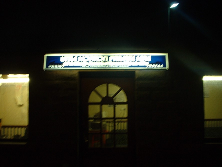

Posted by Stephen Ingham on 21 January 2005 at 22:23Hi all, I recently did some light boxes and went down at night to take a snap of the boxes lit up, you can see the results…………..
I don’t claim to be any type of photographer, fuji digital camera, point and shoot!!!!!!!! 🙄
Any advice on how to overcome this blur effect??

hi chaps, i think that one of the probs i have is that when i turn the flash off the camera is very sensative…… hense the blur, a tripod is a good idea i’m sure, have to give it a go.

Same here. When I turn my flash off the camera automatically goes to a time exposure of about half a second which causes blur and overexposure. Try a tripod and also look in the manual for the camera and see if you can turn down the exposure and/or white point. I did this and had some success but my camera is just not quite good enough for night time pics.

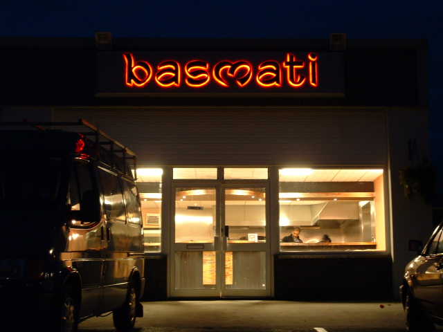

You can try to take a photo by this simple method. Stand far enough back to compose the picture. Sit on the floor and rest your elbows on your knees thus forming a sort of tripod. If you can lean against a wall as well even better. Line up your photo ready to take, make sure you are as still as possible, and now don’t laugh as the next bit is very important, HOLD YOUR BREATH! This makes sure that you are as still as possible. When you take the picture GENTLY SQUEEZE THE BUTTON……..Do not STAB the button as this will also give you camera shake. Hold this position for at least 2 seconds while the shutter operates as it will be a lot slower than with the flash setup.
This picture was taken using the above method.
