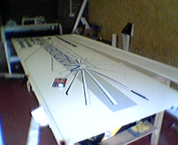

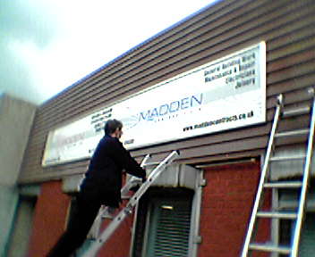

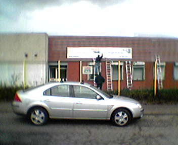

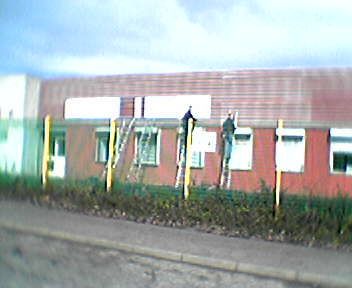

    Panatrim comes in 6m lengths so how do I make something longer than this? We fitted a 6m long sign last week but it got me thinking. We made the full frame before we arrived and then transported on top of a long wheel based transit. It took about 2.5 hours to fit with three of us, first time so we called in extra help!

    PS just found a photo… not great quality coz on my phone.
