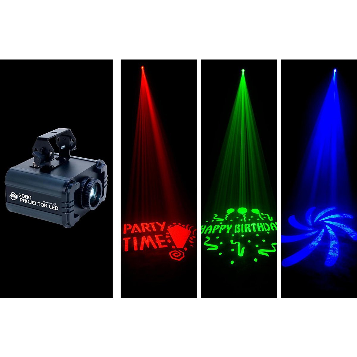

    However, i am thinking its more a Gobo Projector you are after rather than a Hologram.
    these are much easier to come by and not as costly. in fact, i used to rent a very crude version of these to some of my customers around 20 years ago.
    As your from scotl;and you may remember a Glasgow store called "Victor Morris"?
    i would buy second hand night club oil-wheel projectors for about £40 each from VM.
    they came with options of oil wheel filter lenses. "Like the gobo lens today" anyway on the lens i would cut in black vinyl, in reverse and stick it to the lens.
    when you turned on the projector it shot the logo onto the wall/floor/ceiling and continually rotated it.
    i would rent these to customers when they opened their shops or did promotions.
    work very well and projected logos right across streets and the like. (get permission first) 😀
