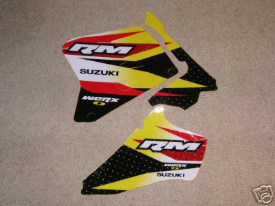

    I’m in the development stage of producing custom motocross graphics,I need to find a machine that can punch holes in the vinyl,see the pic bellow,where would i find this kind of machine?

    the holes are to allow the gas tank to breath,

    hi can you not use a banner hole punch you can get different sizes at hardware and camping shops
    i have some in my toolbox for quick banner repairs

    Can’t you just cut the holes with your plotter when it is contour cutting the graphic or am I missing the point 😕

    not sure if this would be useful as a manual process but it is a hole maker for remote control cars body shells. They make round holes in plastic and might be able to help you with what you need to do.
    check out this site and link to see what I am talking about. (it’s called a reamer)
    http://www.modelsinmotion.co.uk/categor … tamiya=258

    it would be possible to have the plotter cut the holes but it would be awfully fiddly picking them all out,it’s also not really possible to do it manually,because the holes have to be uniform.

    You could possibly use a paper drill.

    anyway, vinyl cutter does the holes or cnc flatbed with twin heads (one knife and one drill?). For mass production then silkscreen then using a die-cutter to stamp the lot out.

    moto x, trials, road racing, etc only need one small one usually bulilt in to the tank cap design i have seen these sort of decals with a sort of perforation (dimpled effect) which i think is only to help grip the tank or panels with your thighs ( sorry Girls) its a man thing.

    Derek, I think that polyprop tanks leach out petrol vapour which in turn affects the adhesive, that’s what I have been told anyway, I cant understand how the vapour would decide to use the holes rather than affect the adhesive though?
    Thats why I asked the question,

    yeah the tanks release fuel vapor,with holes obviously it allows allot of that vapor to get straight out into the air,so their is no ‘know’ solution to this problem?
