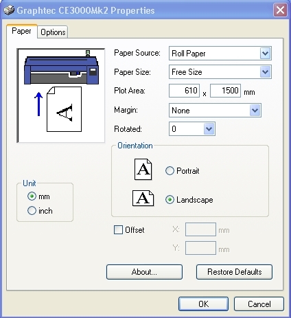

    but the main thing is i need help with my new graphtec Ce3000-60 Mk2
    i have a big ( long) job come in and i need to cut 3.5 metres long x 360 high and i can only get 1500mm x 610 in the printer prefs. ! argghhhhhhh
    I’m using the graphtec as a windows printer as graphtec recommend, corel 12 and graphtecs ce3000 cut controller
    please someone shed some light on how i can get around it without having to do it in 3 parts.
    thanks
    Jim

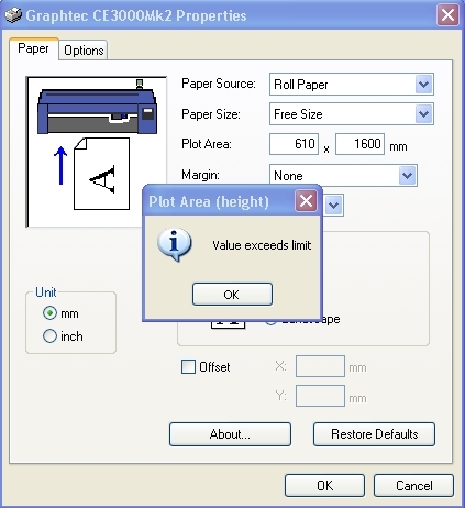

    yes i can set the size to what ever i want in corel but its the printer setting in windows it will only let me go to 1500mm if i set it at 1600mm + it pops up a box saying value exceeds limit ( see pics attached)
    1, the cutter can handle 5000mm long in its own settings on the machine.
    2, ( after entering in 1500mm + )

    8 October 2006 at 19:53
    it will run to the edge fine ( most of what i do is only a paint mask ) so it doesn’t need to be smooth, but my problem is the length of the roll not the width.
    i don’t cut to the edge any way i just do it so i know the exact size I’m dealing with.
    Jim
    8 October 2006 at 19:55
    The plotter returns the value of the actual width available, so it dosnt match 610m
  • JIM COUSINS
    8 October 2006 at 20:02
    ok so if i reduce the width it still dosnt alter the length.
    it will cut fine with the 610 x 1500 but i just need to be able to go 3500 not 1500 as it falls right on a certain design that i dont want in 2 bits.

    10 October 2006 at 20:28
    hi Peter and Alan
    thanks for the help but still no avail.
    tried everything i can , altering sizes everywhere and different setups etc..
    but still can only cut 1500 mm long.
    this is really driving me crazy now.
    jim

    11 October 2006 at 21:40
    got it all sorted now ! wooo hoooo
    windows will only let you got to 1500mm max
    i have had to get adobe cs2 and use a cut manager on the disc.
    its not bad and i managed to cut the 3.5 metre long design today,
    Just trying to get the hang of adobe now is going to be a pain as i am quite handy on corel.
    i spoke to graphtec today
    Jeff at Graphtec (UK) is brilliant !!
    he is going to send me a bit of software that will let me use corel with the same settings as the adobe cut manager.
    so fingers crossed, and i will be happy cutting again soon on corel !!!
    thanks for all your help
    Jim

    I’m all sorted now. but yes it does have that function but that wasn’t the problem ,
    The problem was the windows printer preferences will only let it go to 1500mm and you cannot do anything to change the settings only reduce them
    It has to be exported to another program that will acknowledge the size.
    like cut studio etc…
    using the windows printer devices is OK and easy for small jobs but if you need longer then you need a cut manager program.
    thanks for the help again all !!!!!!!
