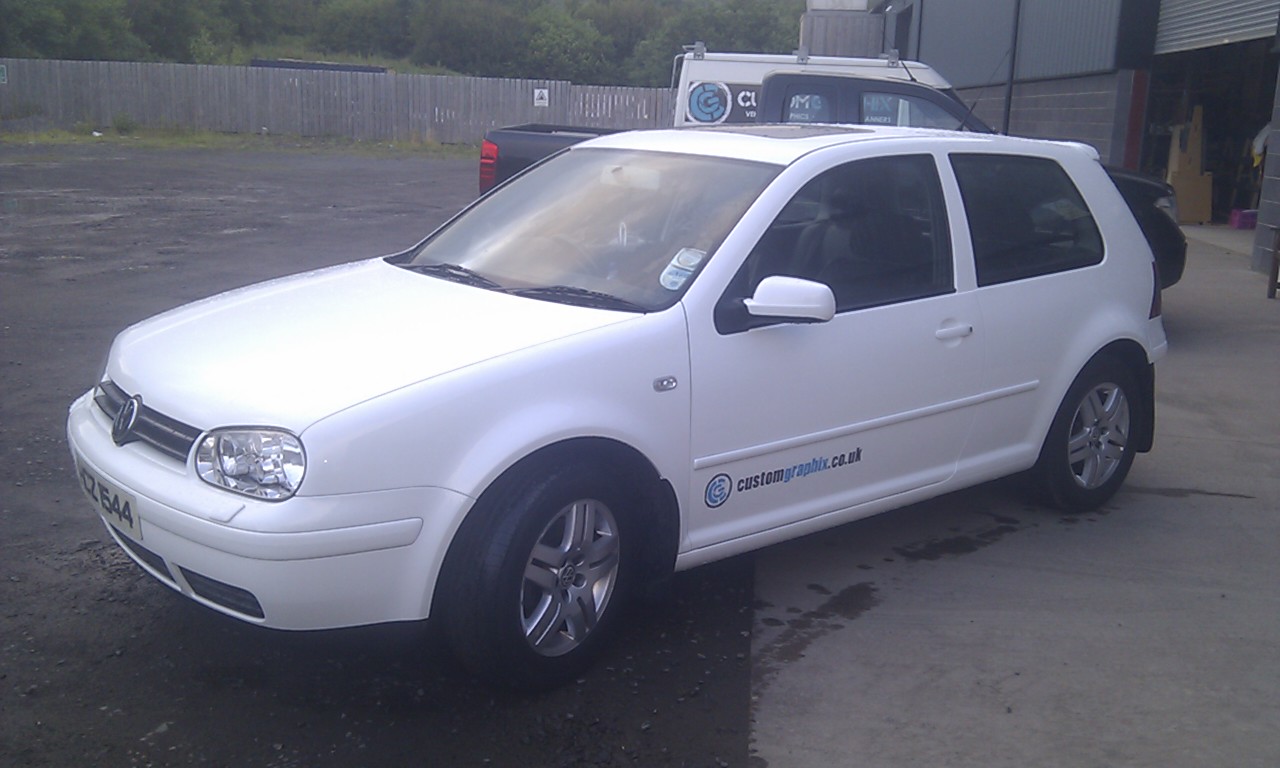

    Hi Everyone i wrapped a mk4 golf 2 weeks ago in hexis wrap vinyl Metallic white with air release, i have wrapped with other vinyls with no issues, the car was washed, dried and cleaned with iso cleaner etc, we only used heat enoungh to shape the vinyl and post heated every bend, my problem is it is lifting in places already.. has anyone else had this issue?

    where is it failing mate?
    can you post any pictures of the failed areas?
  • John McNickle
    22 August 2012 at 12:06
    ill need to get some rob, it has popped around the bump strip on the passenger side as its ia bugger to take off, around the corner of the bumpers down low and the mirrors 🙁

    I know what you mean rob, the car is fully colour coded, i know nothing sticks to the standard plastics but this is all factory paint, ill get pics tonite i hope but i have broken my phone at the mo and using one that fred flintsone had before me 🙁

    sorry im only back into this discussion, i had to cut down the bump strips to releave the tension on it but its been shrinking a good bit and there was no over the top heating or bending involved 🙁 i had pics but this useless phone wont let me put them up on here, ill sort it over the weekend..
