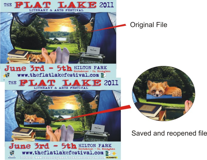

    Whenever I design something with a ‘cutout image’ in it, everything is fine until I save and close the document. When I reopen to begin work again and try to move the cutout, it takes a lump of the background it is on with it. Hope that makes sense, Is there anyway to avoid this?

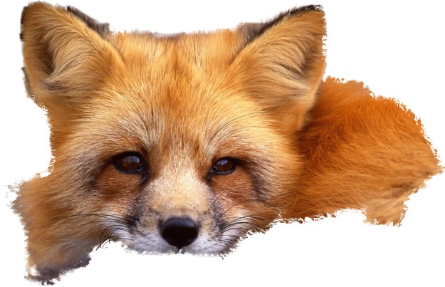

    Hugh, the fox is cutout like below so that his snout will drop in over the lip of the tent. But when I save, close then reopen the document and try to move the fox, the background has attached itself to the cutout. (I’m still not making sense, am I???…lol)

    you’ve cut out the fox in that shape (is it power clipped?), lay it in place and save but, when you remove it (after re-opening, it’s changed into the std rectangular jpeg pattern and included the background that was within the rectangle (the rectangle was probably the original boundaries of the photo).
    is that right? i’m not sure how you’ve cut it out but i use powerclip (through ignorance of other methods) and don’t have this prob in 12 or X5.

    I use powerclip which works fine for most things but for something like this (hairy irregular shape) the ‘Cutout Image’ tool in Photopaint gives brilliant quick results. Just a pain that I haven’t figured how to keep it as a cut out.

    Try saving the clipped fox as a gif Harry as Jpg does not support transparency.

    I think I’ve got what you mean, when you save the whole thing as jpg it is combining the bitmap elements (You normally get a warning in PP) save as cdr and they should be separate or save the fox part as cpt. The issue could be when its powerclipped you cannot get at the fox in which case , control double click will will anable editing the powerclipped objcts and right click – finish editing at this level will powerclip it again – saves extracting contents.

    Yep Alan…thats it. i was just cutting and pasting the cutout back into Draw when I finished with it. Saving it as a gif as Steve says seems to be doing the trick.

    Glad you got it sorted but I don’t think GIF supports as many colours as JPG or PNG. CPT or PNG will support the transparent background and all colours and is good for saving from Photo Paint for importing into Draw. I think saving as psd will do the same.

    Used a PNG and worked perfect!
