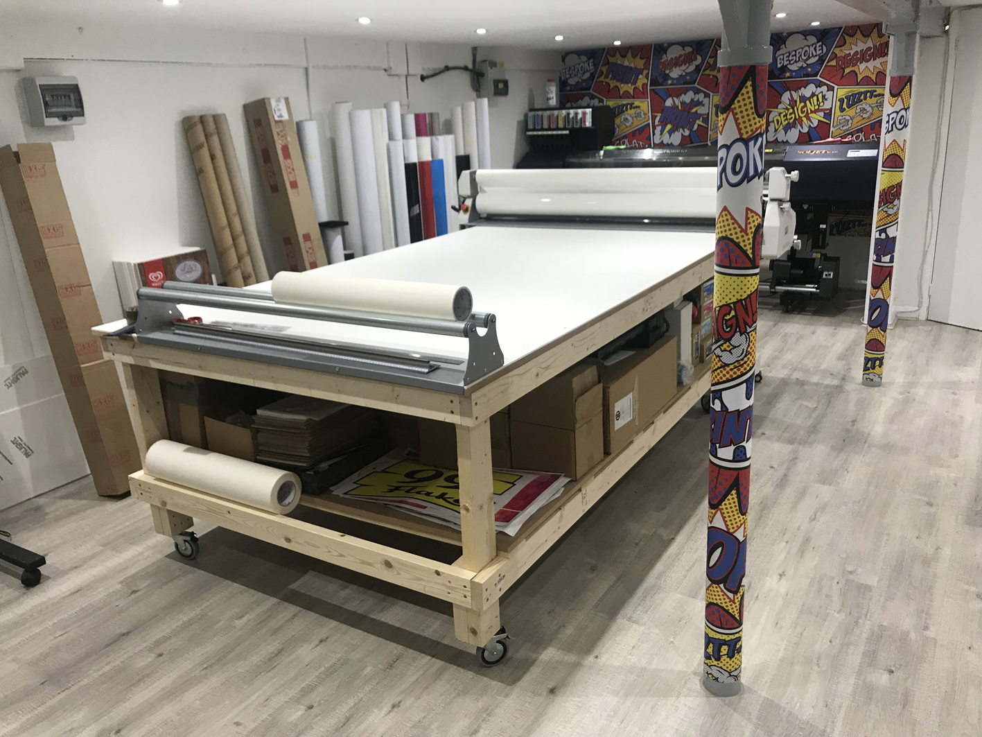

    Hi guys, just built new workbench (cost about ยฃ160 in materials) and very happy now just want to put a glass top on it, need some advice on the correct glass and thickness to ask for, tia.

    The table looks great, really solid looking and mobile. I like the graphics you have on the wall and posts to. :thumbsup:

    Very nice, looks just like mine. What size is it?

    I’ve got a 10mm glass top. I personally don’t think I would go any lower but then my top is clear apart from 1 bar that runs along the middle. The idea is that run some leds under the glass. My table 1090 x 2500 but I have 2 of them and both on wheels. When needed I use them length ways and I have a 5mtr table or if in need the width then I have a 2mtr x 2.5mtr table. I also have a another glass top but I run out of room so it’s leaning up against the wall. I’ve stood on my tables and I’m nearly 15st

    Thanks all, think Iโ€™ll go the 10nm toughened glass then ? Is that name or do I ask for something specific? Tia

    Thatโ€™s not bad Iโ€™ve been quoted for 2440 by 1500 6mm toughened ยฃ230
