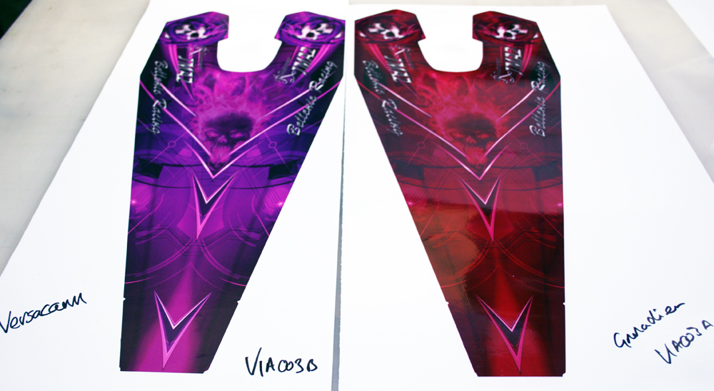

    Hi guys, I wonder if anyone can help….
    I have a versacamm and a grenadier
    I’m printing the same image on the same media set up through the same program to both printers and I’m getting quite a large colour variation between the two. Can anyone shed some light on how to get the same results accross the printers?
    They are both using versaworks, the only main difference I can see is that the Grenadier has 6 colours (12 really but a double up) and the camm only has 4..
    Se attached photo cam on the left, Gren on the right.
    The 4 ink cam image on the left is almost an exact replication of the colours on my monitor when printed
    any advice would be greatly appreciated
    Regards
    BigMo

  • Chris Wool
    21 March 2012 at 17:37
    although you think you are using the same settings it should be using 2 different profiles.
    presume the same inks in both machines.
    personally i don’t think you will ever match them perfectly you may get closer but not the same.
  • Mo Gillis-Coates
    21 March 2012 at 17:49
    quote Chris Wool:
    Thanks Chris, close would be good as ones red and the others purple….. lol the profiles are slightly different, how do I start getting them closer?
  • Chris Wool
    21 March 2012 at 18:47
    you could try hate saying that as its not a answer but
    if the grenadier is wrong then
    in VW colour adjustment add cyan a bit and reduce mag a bit
    or in edit tone curves select cyan only and bend up about a square.
    try a small test print.
    for a similar output quality the grenadier should be printing around 2-3 times faster because there is more head area in use per pass
  • tony prior
    12 April 2012 at 11:50
    isn’t the Grenedier a B&P machine which uses different inks – unless you are using Roland inks the profile will not work
  • David Rowland
    12 April 2012 at 13:23
    Must be Same Rip, Same Profile, Same Computer, Same Ink set to match
  • Stafford Cox
    18 April 2012 at 10:07
    Totally agree with Dave. A 6 colour and 4 colour profile will give you very different results.
