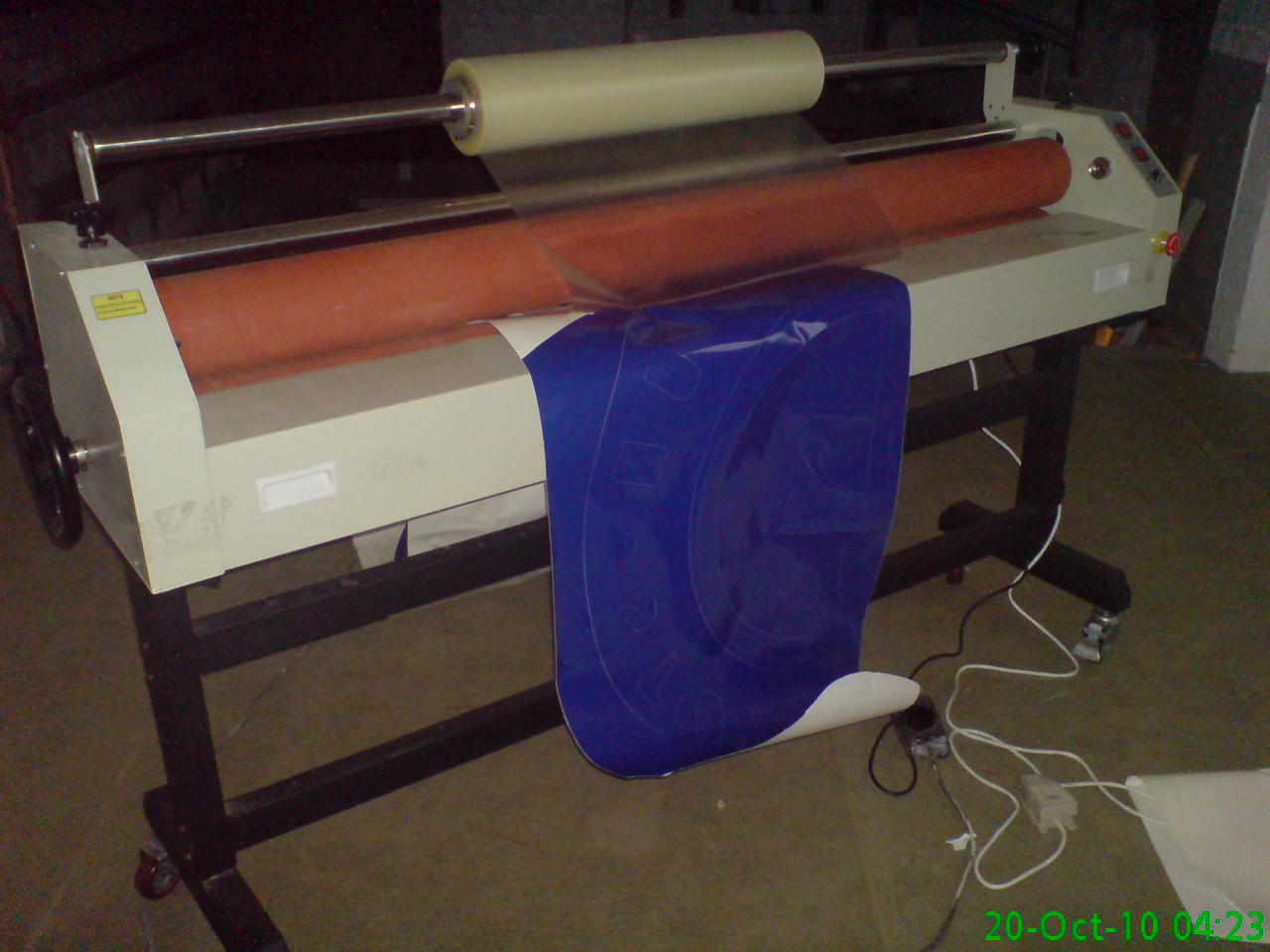

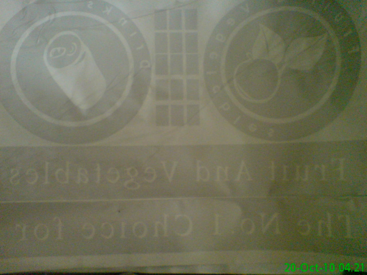

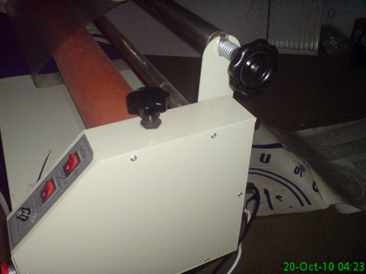

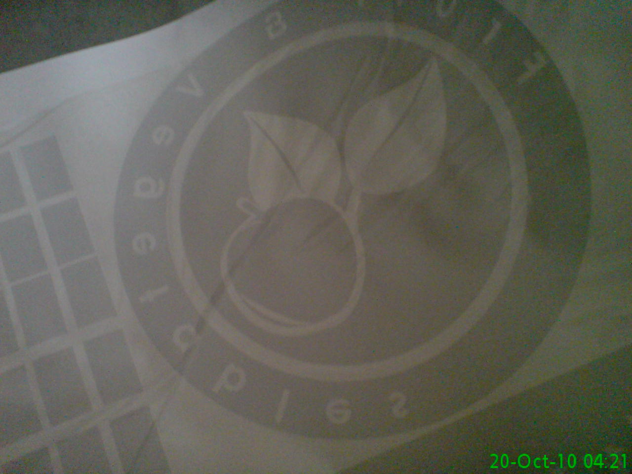

I have alot of large graphics to apply application tape to, so thought i would use the laminator which i bought not long ago. the laminator is heavy and seems pretty reasonaable as in the pic but the usage instructions are rubbish and vague. I was hoping if i could get help on why it is creasing the graphics and app.tape when used through the laminator. I have the pics attached.

I would say you need a bit of tension on the app tape, I cant see if the roller holding the tape has a brake, but doesnt look like it has. also you do need a bit of pressure on the rollers if the weeded vinyl has large areas of backing paper showing.
It may also help if the app tape is fed under the other steel roller (if it is a roller)before going on to the rubber one.
I recently did about 30 metres of 1220 on my laminator, without to much of a problem, it is a bit of a learning curve, but should be possible

clear tape is horrible to use anyway so first off it will be much easier with paper.
It also looks like you are using too much pressure and that’s why it’s "warping" I don’t think you need a brake or tension on the roll as long as it comes off smoothly (clear tape usually doesn’t though I found – again use paper tape) Paper tape creates it’s own tension due to being stuck to itself on the roll.
lastly make sure the roll of tape is secure on the bar and can not move, should have guides to tighten up against it to hold it in place. If the tape and graphic is lined up then it should run fine especially at 610mm wide.

the app tape itself has no backing warren. if i did put through the other bar peter wouldnt it stick to the bar as the sticky side is the exposed upper side??? Also I had the thought that because the app tape is stuck to itself on the roll and as it is getting realsed there is resistance there but not on the graphics. so would that mean the graphics is moving at a faster rate then that of the app.tape?? if so would this be the cause????

You could try having some one pull tension on the application paper when it is through the machine before putting the vinyl through so it is tight and smooth, other thing is company I do a lot of work for run the vinyl through on a backing board of 3mm mdf. I would say stay away from the clear application paper I have never found it to make work any easier, every time I have used I have had problems.

Phillip you are correct about sticking to the bar, my laminator had the bar higher than the roller the material is loaded on so the non sticky side would feed over it, rather than under it, sorry If I mislead you
