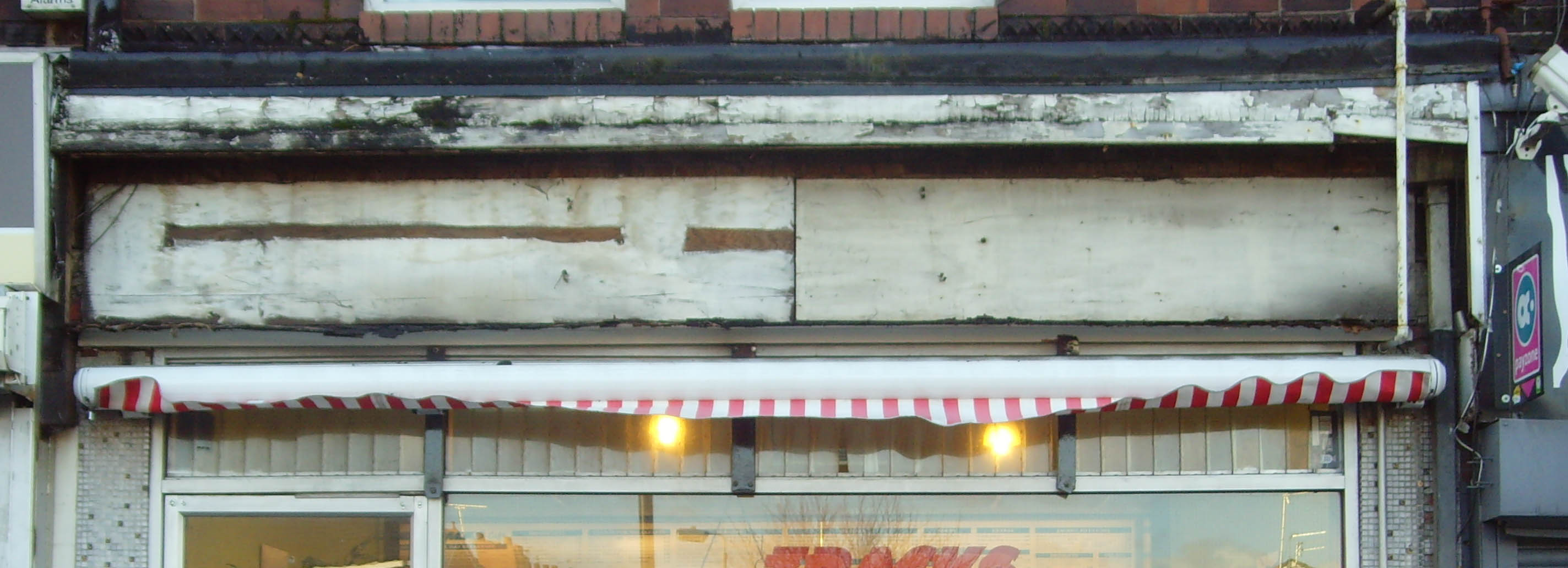

    One of our neighbouring shops signs has disappeared in the recent stormy weather we’ve had. The entire thing as you can see from the photos. The timber is clearly rotten.
    I know that some kind of frame needs to be re-built along the bottom, as there’s the remains of some ply wood left, with some steel brackets holding it to the wall.
    Ideally the customer doesn’t just want a flat sheet screwing to the frame, and we have discussed sign trays, and fitting a frame.

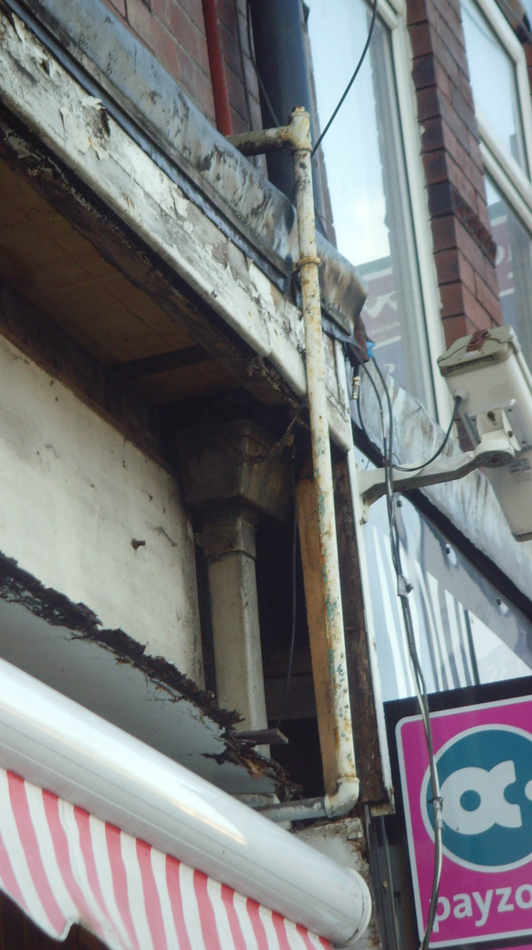

    Trouble is that there is gas pip running right in front of the location, so that rules out a sign tray. A sign frame will be problematic, as the empty shop next door has a CCTV camera, and PayZone sign sticking out.
    I am just after opinions as to how is best to install this sign, and suggestions of suppliers for the frame – ideally pre-made.

    5 January 2012 at 14:54
    I wouldn’t build out with a tray, I reckon that if it’s too tricky to do that then get a good chippy to sort out all the wooden facia, I’d say from the looks of it that the original shop front is the bit in the recess and the roller shutter / canopy thing has been built out, get the chippy to build it all in nicely and put either a tray or flat panels in the recess, a reverse tray!
    either that or get the said chippy to repair and build a frame, have it protrude enough to fix a tray to it.
    the only other way I see is to hacksaw thru the gas pipe and hope no-one notices – ok, don’t do that but maybe get the gas pipe diverted? stupid place for one!
    5 January 2012 at 15:33
    Re-locating the gas pipe will be problematic as it feeds the residential property above.
    I am hand enough to knock up a decent wooden frame. It’s completely hollow behind, same as all the other shops on the row.
    It looks like the sign was in place and then the gas pip was fitted around that.
    So the sign needs to come out the gas pipe which will make fitting a sign tray ‘difficult’, without taking down the neighbouring (empty) shop’s camera and crappy signs, and try slide it onto the frame.
    I’m open to ideas.

    5 January 2012 at 17:44
    Getting prices in for a chippie to make good the woodwork behind. So that will be a fixed cost + markup.
    Thinking about it and speaking with my tray manufacturer. I will get the tray made, but not have the fold on the end where the pipe is so it will be possible to slide it along the frame. Screwed along top and bottom full length.
    The end will be hidden, or a blank put on to hide the timber. The customer had a flat panel sign and it blew down. I’ve shown him a folded tray, and how rigid it is compared to a flat panel.
  • Kevin Flowers
    5 January 2012 at 22:13
    David
    can you not add an additional 50mm timber to bring the frame out flush or just past the pipe then recess the returns of the tray to go around the pipe. This will improve the appearance & probably win you some brownie points with the customer for giving him a better looking sign. If a sign frame will fit behind the pipe then just make the panels front loading insert the panel that goes behind the pipe first, slide behind pipe then insert second panel but ensure you have the rebates machined to allow you to do the right panel first

  • NeilRoss
    6 January 2012 at 10:37
    To safeguard yourself from future storm wreckage I’d say that was a job for a joiner. I’d get the client to have a joiner strengthen the existing fascia (what’s left of it) and build it out as Kevin says, as a separate job. The joiner should liaise with you to make sure it’s all going to work out for you to fit directly to. Then bill separately for the sign work. There may not be too much extra cost as although the joinery work will cost, there will be less work for you to do when erecting. The trouble I’ve found in the past with doing it all yourself as part of the sign erecting process, is that the client will not appreciate the additional structural work and consider your services over priced. If you try to help him out and save him money by doing a quick bodge then when the next storm takes it down you’ll cop for a shoddy job and be expected to replace at your own cost. It needs to be done properly – the whole thing looks a bit Heath Robinson – probably been patched up a dozen times before and could do with sorting out anyhow.
  • Stephen Morriss
    6 January 2012 at 15:28
    You’d have thought they would divert the pipe off to the side just for their own aesthetic satisfaction.
    I’d consider fitting the sign in 2 parts, the short one should fit in without moving the camera, and have the join behind the pipe.

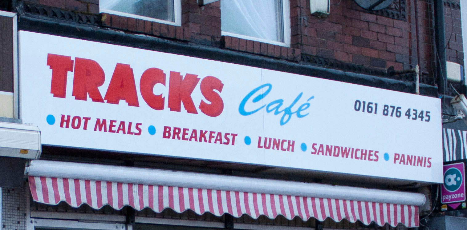

    UPDATE:
    Job is completed just this afternoon.
    My first sign tray, and it went up ok… a few issues but we resolved them.
    The designs nothing exciting customer just wanted the same as he had previously.

    20 January 2012 at 18:59
    Its one of the best looking signs along our row of shops.
    My joiner made the framework up, and I ordered a tray to fit, from a new local supplier who’d called in on spec last week.
    Need to allow even more extra on the width because of the rivets on the corners.
    Its given me a boost of confidence and I’ve got photos for each stage from beginning to end!
    Customer won’t see it till tomorrow when he opens.
