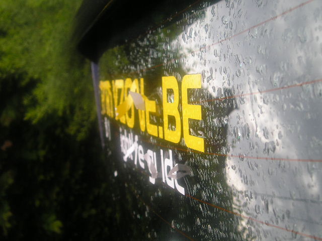

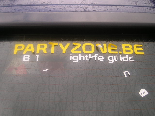

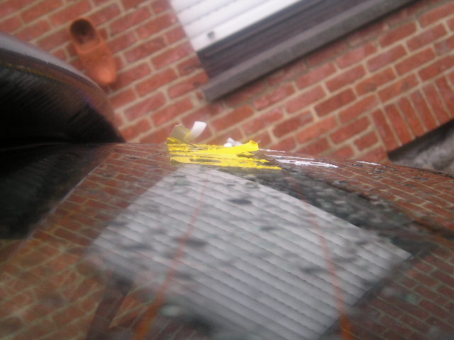

    hi all,
    i have a problem and i don’t know what it is, if you look at the pics below you’ll see that a sticker has come off.
    client putt it on himself, i wasn’t there but he told me he degreased the window, applied the sticker and then let it set for 15 minutes before driving,
    it was raining that day as he drove outside of his garage and claims his windshieldwiper wiped some of the letters clean off.
    material used was imageperfect 3500 series
    did a litlle test here with material from the same roll and after putting it on a window (not degreased) and waiting for 60 seconds i had the hardest time pulling it off. roll was 2 weeks old
    it’s not the material i’m sure,
    what in the world did the guy do to it?

    i’d bet he put it on wet without squeegying it properly, then his wipers wiped it off ! i certainly wouldnt be held accountable for this !
    i think it would be very hard to wipe off vinyl stuck on clean glass dry, i dint think i’ve ever ‘degreased’ it either, even put on wet it is usually poperly stuck on within a few minutes, use somoe of the same vinyl yourself, and put it on glass, do both wet and dry and see what happens, i bet nothing !

    as hugh says… if it was applied wet, there is your answer. even squeegeed till your knuckles hurt, it will come off if hit with the window wiper shortly after. just one of the many downsides of wet application, drying/curing time. wet application on glass is worse than wet app onto something like a vehicle body.
    who is to blame? he is… you cant be responsible for HIS application. never mind him putting window wipers on right after.
    how could it have been avoided? i would have applied the vinyls on the "inside" not outside. even inside ide have done it dry but that’s irrelevant. even if you apply the graphics to the outside dry, yes they will stay on. but a couple of months down the line you will have dulling or streaks rubbed into the graphics due to the wiper passing over them.

    I think your client stuck that sticker on wet with window cleaner, which damaged the adhesive.
    Then used his wiper.
    It’s up to you…I’d eat the job, stick it on myself, then see what happens.
    He’s probably just like everybody else, trying to get something for nothing.
    Good luck.

    I wouldn’t fit vinyl of any type in the arc of the wipers. It’s going to start lifting at the corners sooner or later.

    I think the advise here is good.
    I’d clarify your warranty when selling window decals.
    1) Not to be put in wiper blade area.
    2) Do not apply wet
    3) Final polish the window with water before fitting
    4) you take no reponsibility with the fitting.
    You can’t be held responsible for this, wether your client is a good one or not.
    I’d suggest the client did it wet, I wouldn’t believe otherwise.
    I’d be using a cast material for the best adhesion. It is the best material to cop wiper abuse (thinnest and usually best solvent based glue)
    I’d be advising your client to leave for 2 days of sunshine at least, not 15 minutes. You need a bit of heat to activate the glue for maximum adhesion.
    I don’t know the material, but wouldn’t mind betting it is probably a water based adhesive, which will the the start of your problem.

    No matter what spandex ‘spin’ it as, it is a promotional grade material at best, with low (they say medium 🙄 ) adhesion. It has a shrinkage rate outside that is excessive in direct heat (from personal experience)
    I’d suggest it is the wrong product for this use.
    I’d be using 751 or 851 from Oracal. If you can’t justify a cast, at least use a good quality polymeric.

    From the pictures you can see the vinyl is not torn and has been cleanly lifted. This tells me that the wet application has not had time to dry and that the wipers were doing their job.
    I agree with the consencsus – don’t put it in the wiper area and apply it dry.
