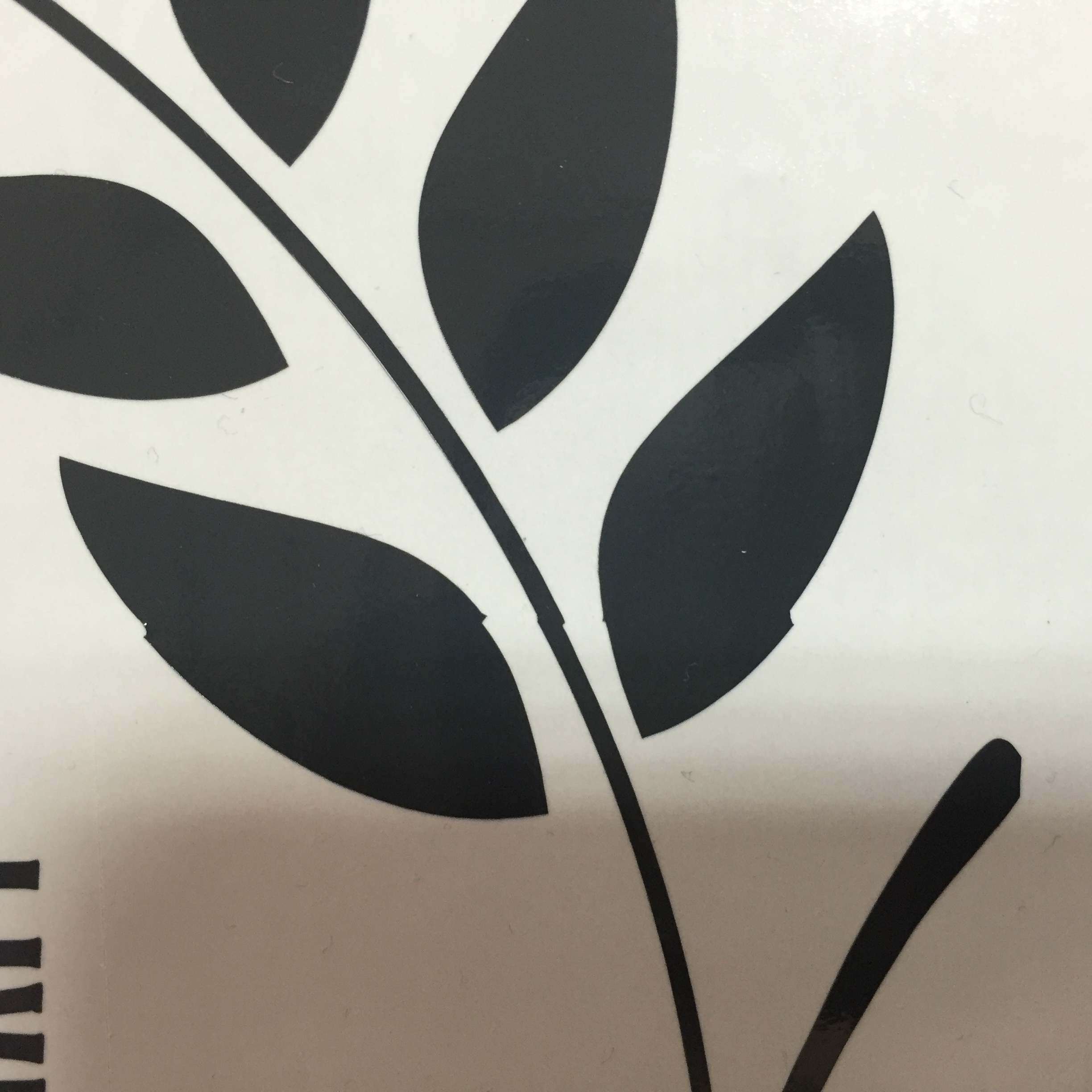

    Hi All had a new Summa S2 T 160 installed, (CWE / Paper Graphics) one of the reasons we bought the machine was to cut long jobs, we are using the option, paneling, not opus paneling, for cad cam vinyls, the problem we are getting is its putting notches where it starts and stops, sometimes there very small some times there 3mm is anyone else getting this problem when they use it ?

    Hi Gary
    Although i dont have a summa, i do have a similar panel option with my graphtec
    from the picture, it looks like a 3mm overlap.
    if you move everything 3mm higher it will all line up.
    we use it a lot when panelling for large wall/glass installs
    gives an overlap to match into
    not a solution but hope it helps

    Sorry i should have claryfied
    The notches are where the program thinks the panel starts and ends including the overlap
  • Gary Barker
    23 June 2016 at 07:05
    Hi Iain thanks for the reply, this is half way through the job its not an overlap, there is no joint in it, the image leaves are only about 20mm in size, some times there up to 3mm sometimes there 1mm,

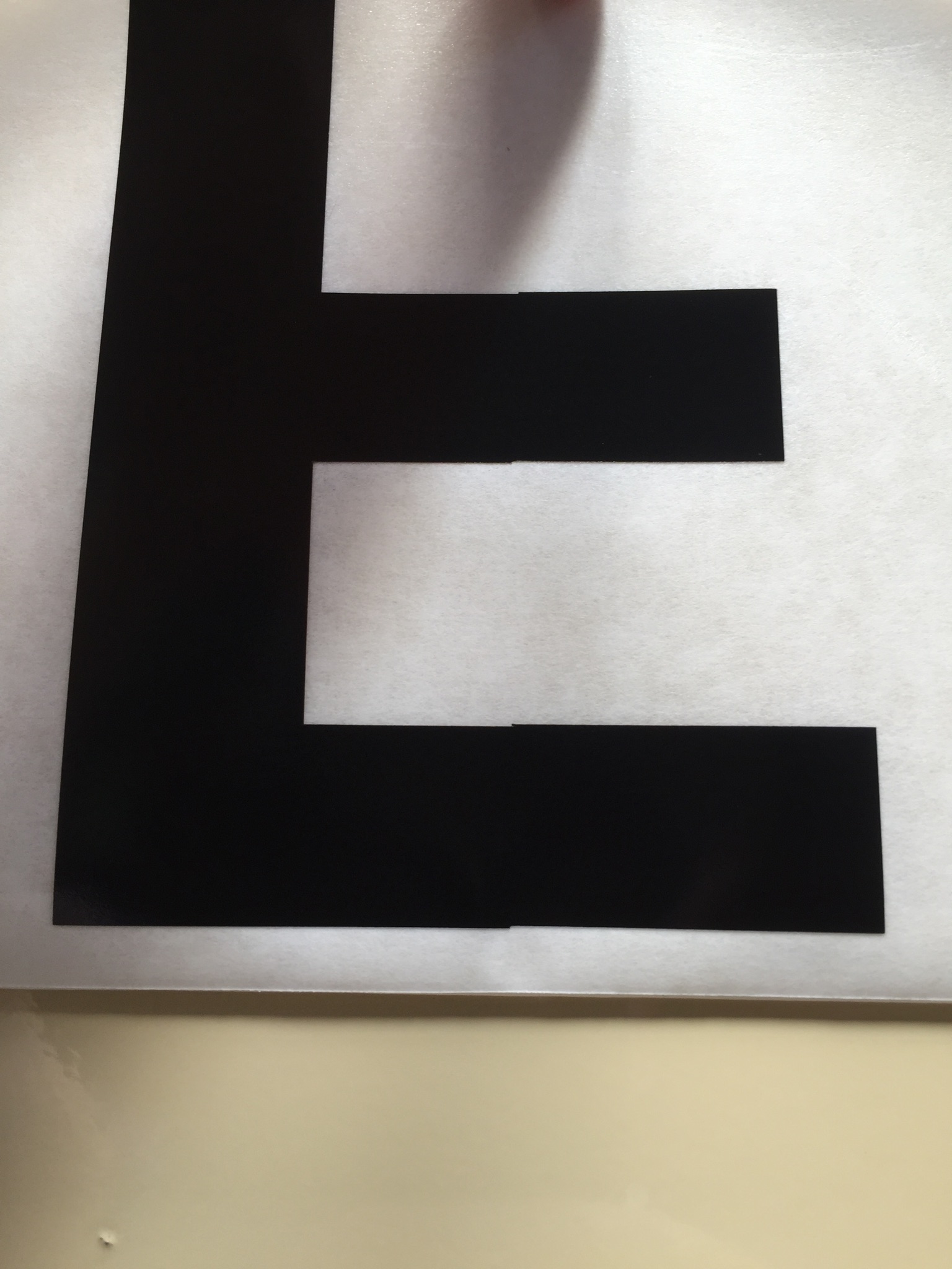

  • Gary Barker
    23 June 2016 at 08:07
    some more picts
