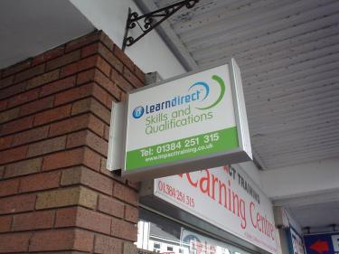

    similar idea to the one ive attached david?

    23 June 2014 at 20:01
    Kind of like the attached. But only 2inches wide, much taller.
    It enables the cables to run inside the gap, and fix angle between the brackets spaced and fix a sign tray in the usual way, then box off top/bottom/sides, or maybe even get large returns on the tray.
