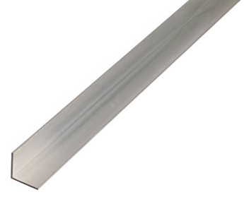

    if it is more for packing to fit the rail mouth you could cut straps and VHB tape them together.
    if the depth is pretty deep and you want to keep it rigid. you could tape vertically, lightweight aluminium L-Shape angle to the rear periodically. it stops any flex or bow that may happen and adds to the overall rigid structure, particularly near a panel join.
