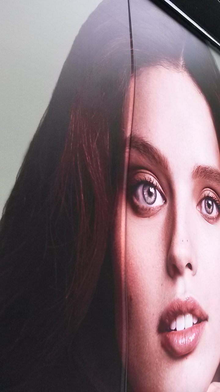

    Hi guys,
    I have applied printed vinyl on a shop window twice in 2 weeks and all I get is wrinckles just next day. I can’t figure out why.
    1st application
    – Avery mpi 3601 printed on UV Arizona 460 (due to 1800mm width) and applied wet with application fluid from Signgeer. All nice and flat and next day I had wrinkles.
    – unlaminated
    2nd application
    – OraJet 3164M printed on UV Arizona 460 (due to 1800mm width) and applied wet with application fluid from Signgeer. All nice and flat and next day I had wrinkles.
    – unlaminated
    I have applied hundreds of vinyls wet and dry on the windows and never had troubles but I always used Metamark, mainly solvent printed.
    I would appreciate if you guys can provide an answer to this. I meet the customer again this afternoon and I don’t know what to say.
    Thank you!

    7 August 2015 at 10:33
    Could it be extreme heat causing this?

    7 August 2015 at 10:49
    I think 3164 is a water based adhesive, so applying wet might affect the adhesive, so it’s got less grab.
    Hmmm… I think you are right, it’s water-based. I’ve been told it can be wet applied so I assumed is solvent adhesive.
    But let me tell you something, I stayed around it about 2 hours to make sure it is dry and no trace of fluid is trapped underneath. It was really strong when I tried to peel it off.

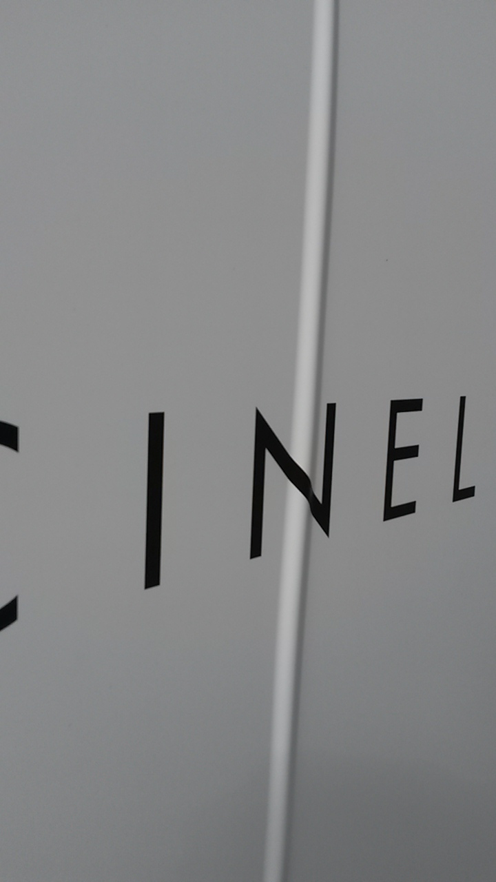

    Now, you can see in the images that the vinyl expanded. It’s an excess of material of 5 to 10 mm per wrinkle. This is weird to me..

    7 August 2015 at 12:27
    Here’s my suggestion..
    I think the tunnelling may have occurred as a conseqence of heat. If you allow a small expansion border around the perimeter (i.e do not fit the vinyl edge to edge in the pane) the tunnnelling will be avoided in future
    This is another issue, Behind the glass there is a "light-box". really stupid idea and design but it is what it is. However, I cannot leave any border around the edges as the light will show and they don’t like it.
