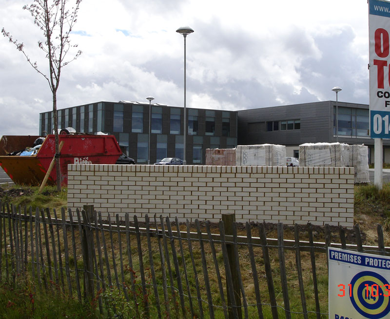

    I am looking for some advice/suggestions please. I have a customer who requires new signs at his new premises. The building, inside and out is very contemporary. At the entrance there is a wall that has been purposely built to house the signs. BUT, the initial idea of stainless letters fitted to the wall has been dropped as there will be a hedge running in front. What the client wants to do now is have the sign on top of the wall, but again he’s decided not to have individual letters. So the canvas is blank at the minute. I have a idea but don’t know if it will work.

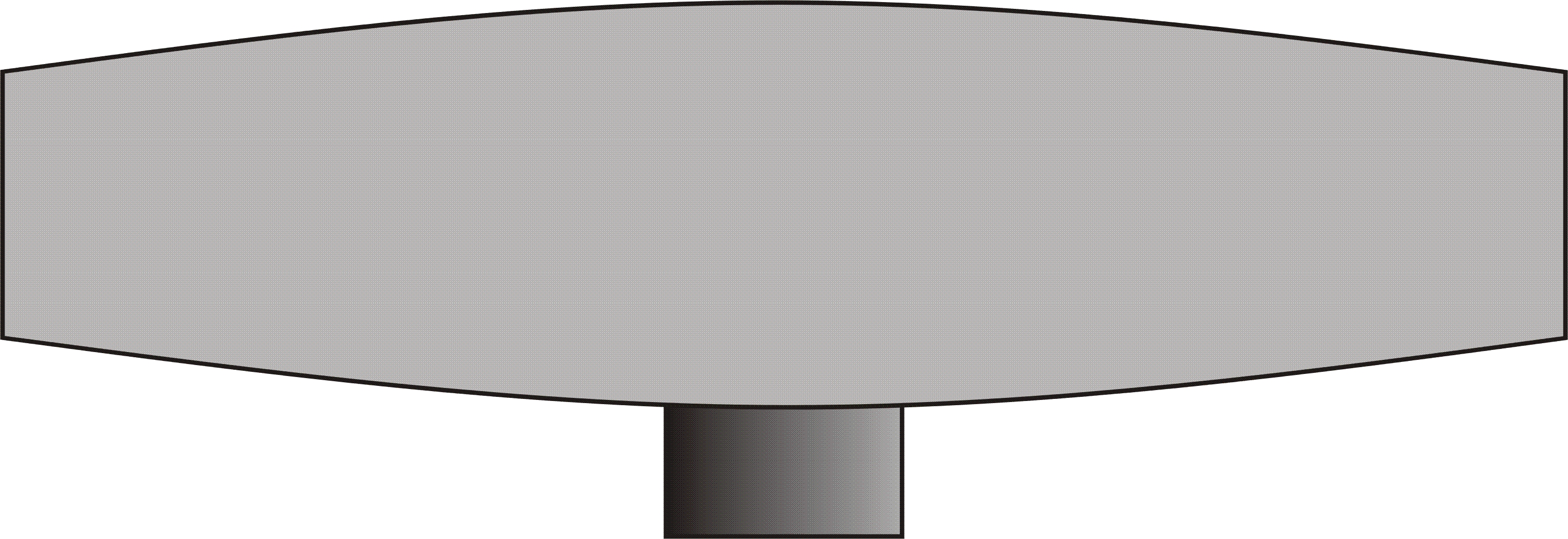

    I thought of an ali sign shaped like the basic pic below, with a polished ‘pedestal’ type fitting fixing it to the wall. Is there a way of bolting this type of thing directly onto the top of a brick wall? If so, who would be the best suppliers for manufacturing this kind of thing?

    Best bet is to contact a local engineering firm to fabricate this for you in something like brushed aluminium. I did something similar a few years ago with very pleasing results.
    In my sign I had a pedestal made up by a local firm and bolted an aluminium signcase to the top.
    The base consists of a rectangular plinth which accepts bolts through into the base – Have a look at a Mcdonalds sign to get an idea how to install this. Good luck 😀

    Marcella you dont mention size, but it would not be acceptable to bolt a sign like this to the top off the wall. it would only be as strong as one layer of mortar, and any moderate wind could bring the wall down, along with the sign. The pedastal would need its own footing, then the wall built in front or around the pedastal to make it appear that it is on top of the wall.

    As for size, I can make that more or less any size really. The wall is 4m wide, I was thinking something along the lines of 1800 wide or thereabouts.
    The walls (there’s another at the other entrance too) are already in place, so rebuilding these is not an option he’d entertain.

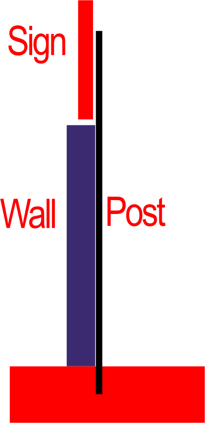

    How about this way?

    My only concern with putting a post into the ground is that the founds for the wall might stop us getting close enough. He wasn’t really keen on a posted sign, he really wanted something on the wall.
    Perhaps he’ll have to rethink……

    Two posts bolted to the wall at the back (using st/st bands)with your curved sign (brushed Stainless) bolted to the posts as close to the wall top so that the posts are hidden by the bottom curve of the sign. The sign will look like it is sitting on the wall but projecting forwards.

    If you go for Dave’s idea about two posts and hiding them with the sign, (which I think is the best idea i’ve heard yet), I would concrete the posts in the ground as well. Don’t worry about the foundations of the wall as you mentioned earlier, you can just kango through them where the two posts will be, and then they will be filled back up agin with concrete when you put the posts in. I am a builder (part time Sign-er), and we have to underpin foundations like this allot, it is only a small wall, and doing this shouldn’t affect things.
