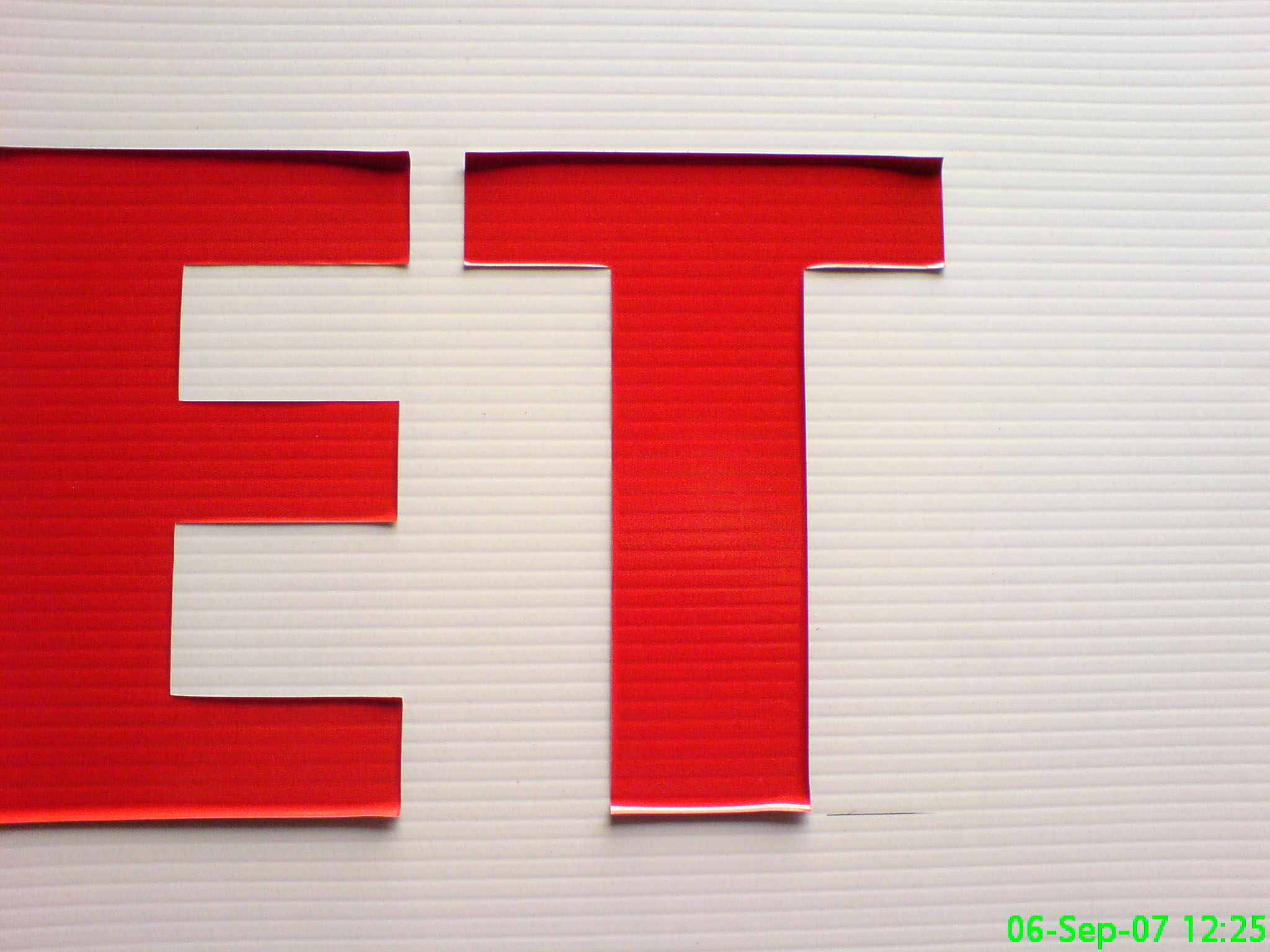

help please Letters peeling off fluted displey board
A couple of weeks ago I made a pair of For Sale boards, on some fluted display board. I printed the logos, and being lazy at the time printed some red lettering as well. The material, a Mactac 3 year digital with removable adhesive all went down ok 3 days after printing onto isopropanel cleaned boards.
I went back this week to make some alterations for the agent to find the red text already removing itself, it was coming off anyway but it’s a lesson learned.
Removable adhesive, digital print and low energy substrate obviously doesn’t workSteve
