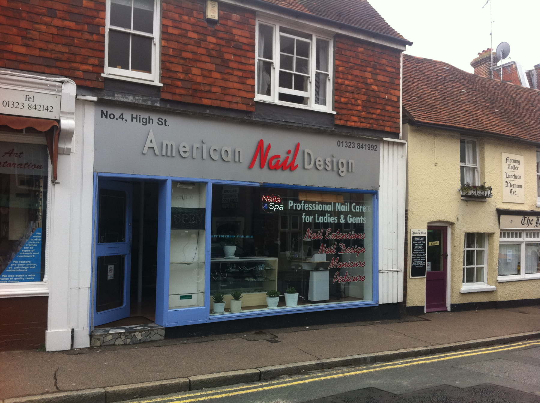

    Hi all,
    fitted this sign a week or so back, bloody typical that the facia and shop front etc are all pi55ed,
    sign is level with the top ledge (which is as good as level), the top of the window frame drops away though,
    how would you finish this? I suggested the customer simply paint the gap in when they repaint the front (on the cards) and no-one will notice the gap but, they want it closed.
    I had considered a simple 25mm wooden quatrant / architrave and he can just paint that in, not ideal but the easiest option, I just have to seal it to prevent water getting and sitting behind it.
    cheers,
    Hugh

    Looks like i’d have to go with the wood option, must be a picky customer though, it’s hardly noticeable, i’d tell them it’s their shop what’s out and not the sign (in a nice way 😀 ), you wouldn’t see that from below it looks like you have to cross the road to see the gap.

    I would put it in a panatrim frame (other frames are available) but cut it to suit the building, then bung in the sign. Job done. To be honest I hate seeing big signs like that held up by screws all along its length, looks tacky. 😳

    😀 Exactly the same here Mike. Sorry Hugh, but i dont mean to be critical, but TBH it would only cost a few quid to finish the job, and you would get a lot of work off the back of it.
    Bar ASDA what other highstreet shops have their signage fixed directly through the face?.
    The very first thing i do when looking at a job is to figure a way of hiding the fixings within the design. This particular job could have been bonded in Place around the edge using a polyeurthane adhesive with the screws on the locators being a secondary back up for hold in place. if the budget didn’t allow a frame. same look but no screws. Also i can’t stress enough how a valuable a good survey is before manufacture. Measure twice cut once, On all surveys i check levels ( even easier now with a spirit level on my I phone)
    I also measure at at least every 2.5 meters the depth, this allows for cutting the sheets of making an off square tray etc.
    PS this is all meant to be constructive criticism,
    Ian
    me too…. however, you know you get those jobs where they want the world but then suddenly turn white when you give them the price? so you give a cheaper option and they still baulk, and again, and again???
    this was one such job, in the end this was the cheapest option I was prepared to do, if they’d gone with the other guy quoting it woulda been screwed on foamex! I had quoted for foamex in a frame but it worked out more expensive than metallic silver reynobond. if the customer had had their way I’d’ve been using the crap and heavy foamex letters which were part of the original 6month old sign which fell down in June.
    I just gave the price and walked away in the end, eventually they came back and we went ahead. at the end of the day though, do you take something and see something for your efforts or walk away having probably wasted 4hrs or so of visits and emails?
    to be fair to myself, and this may be biased, but it’s certainly one of the better signs in the high st, most are happy with crap foamex, recovered old signs etc.. I refuse to use the stuff except in a frame.
    anyways, looks like the wood idea, they’ll paint it so it’ll soon look like it’s always been there.

    HI ian,
    Site survey was done, once when they refused to remove the metal shutters, and again sfterwards.
    I was aware that threre was a 15mm difference between one end and the other, however, the panel couldn’t really be cut to suit as the slope wasn’t even. I was going to install in such a way as there’s only be a 7mm gap top and bottom but the un-even nature and tight fit of the left hand panel would not allow for this.
    bonding? no chance!! sorry but in this instance it would have been suicide, the facia was mad of verticle toungue and groove, screwed onto a timber frame, the whole lot a little on the crap side at best. where the shutter had been removed there was a huge hole too, meaning that around 1/3rd of the sign is not supported if bonded,
    believe me, I would prefer to have done a much nicer job but you can only do what the customer allows, a tray was only £50 more but they still wouldn’t go for it so, as I said above, i threw the cheapest option -I was prepared to do- at them and walked away. I guarantee that not another sign shop in the area would have done a better job for the money, two would have done worse for more.
    anyways, I’ve got rent to pay, some folk can walk away from £400 profit for the equivalent of a days work, I can’t.
    ps, i’ve already got two more jobs from this and am quoting more. If better is in the budget, then better they get. you really should have a wonder around my local highstreet, it’s cheap city, this is probably one of the most expensive in the street!!
    cheers,
    Hugh

    I agree also but within the Clients budget? I would just put timber architrave on the surface around the edge. It covers the screws and gap and paint it with the rest of the woodwork when the painter comes in.
    The sign next to Hugh’s is screwed on the front as well.
    ….and it’s foamex – as are most in the area. I rarely do much in the high st due to being beaten on price consistently, i’ll quote nice gloss composite panel, framed, etc. when the job goes up it’s usually foam, no frame etc – I’ll not compete with foam.
    May I ask what difference the frame would really make to my problem? the customer specified they wanted the whole white area filled, a rectangular frame would still leave the gap – unless I bent the bottom rail down and left either a gap in the corner of the frame or cut the frame end longer and angles to compensate.
