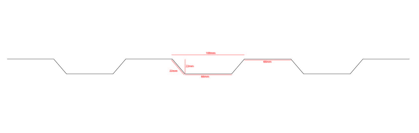

    Hi all,
    I’ve got a client that wants a digital print on some corrugated sheets. Just want to know how you’ll do it. I’ve thought about using a polymeric vinyl and feeding it in, or may be a cast vinyl as i will last longer if it doesn’t fail :shake: .

    I’ve done a few shipping containers in the past & would always apply by feeding in & out as I went. Doing it that way there is no stretch so no chance of a failure. Cast would be overkill in my opinion, since this is a print it is the fading that will determine how long it will last not the actual quality of the vinyl.
    I use to do these using a centre hinge to ensure the graphics remained central 😆
