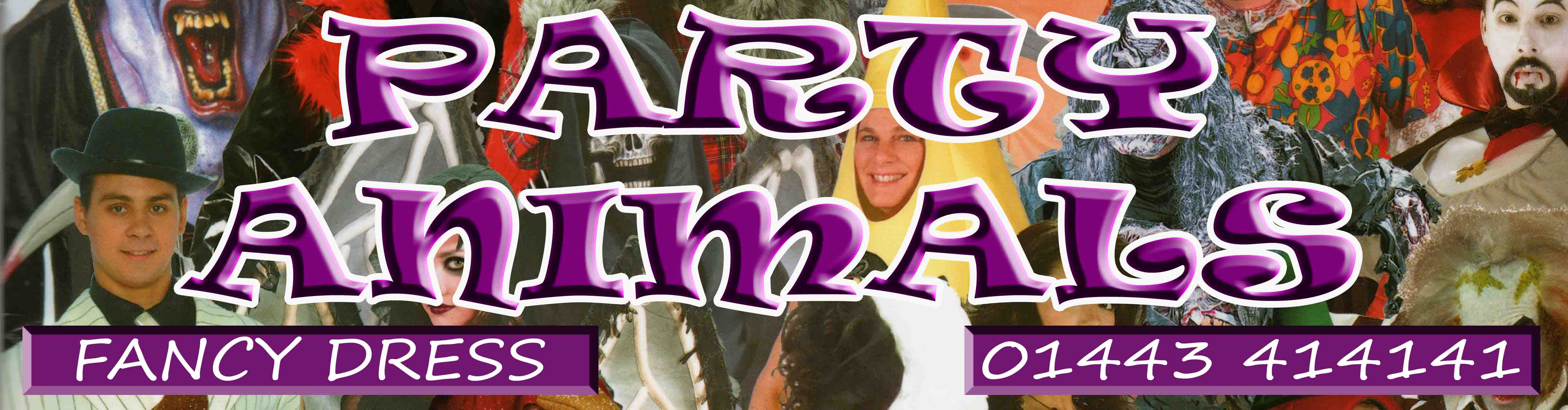

    this will be my first printed sign.
    the customer wanted a background with masks in.
    i was looking at getting the art work printed out at a print shop down the road.
    could anyone give me a rough idea on what i should be expecting to pay?
    the print is 6ft x 2ft
    exterior sign so i imagine it would need a laminate.
    and any tips on applying or what not to do!!
    applying to 3mm alupanel (dibound)

    Also, just a note on the layout if it’s the final artwork.
    Unless it’s a specific design feature – ‘use of borders’!! Free space between lines should really not be greater than the outside borders. It gives the appearance of it being too big for the background.
    Also – be VERY aware that on-screen vibrancy can be nothing like a print, especially of purples on a complex ‘dark’ background can almost disappear at a distance.
    Print it out on an A4 sheet & stand 6 feet away from it. If you have any trouble distinguishing the text from the background – time for a change.
    try fading the background down to 70% to make the fonts stronger / reduce the ‘bevel’ on the main text – personally, I feel it’s a bit too big for the characters.
    And personal preference aside – the fonts could be a little stronger / clearer to enhance their ‘readability’.

    that made it look a lot better fading the background
    will make boarder bigger to.

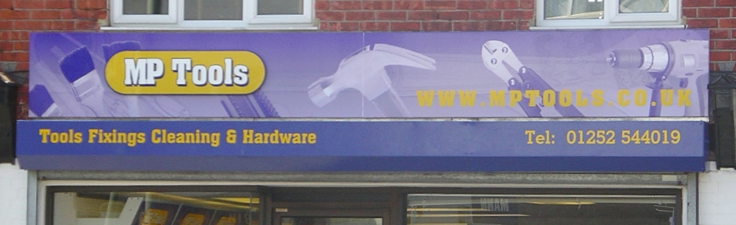

    Apply some transparency to the background so that the eye is not distracted.
    I’ve shown a sample.
  • Scott.Evans
    17 October 2007 at 18:08
    ok then ill try that method will post the result when done.
    thanks
    17 October 2007 at 18:28
    dont know if its the photo…but the mp tools website address could have done with a darker background/shadow/or outline just to throw it out…..the yellow is a bit hard to read 😀
  • David Glen
    18 October 2007 at 08:34
    Yes Nicola I thought that might get a mention but it’s a mobi photo and cropped in as well. In reality it was as clear as day with my back to the wall on the other side of the street.
