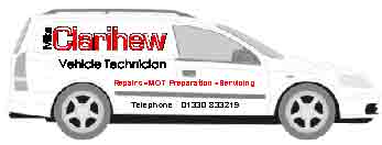

Posted by WP_Graphics on 8 July 2003 at 17:59here’s the file….

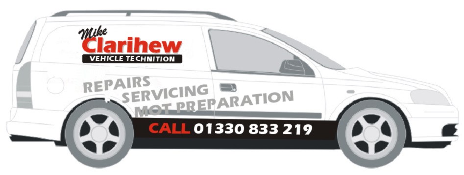

Something different to think about,could give you some more ideas. I generly try to use letter style that have some sort of style if you now what I mean and as the teacher’s say at tech (in aus) dont be afraid to use panels. This is just something fast needs more work yet but it’s probly the oposit of what you are thingking of.
I like the look of these both guys, Never have thought about covering a section of the panel in black, might try it….
Anyone got any more suggestions and also, where do you take your level off on these cars??
Gav
an easy way to mark a level…
use the sill as your level or….
use the rubber moulding. this is what i use..
i come up something like 10inch from it and make a few marks.. then run a masking tape from almost one end of van to the other.. this gives you a straight & if you think its not.. stand back have a look.. then move it up down, whatever… once you think its in the right place.. size all your lines of text from the masking tape..i think you will find if you run it off the moulding like i have said, you wont go wrong! 😉
