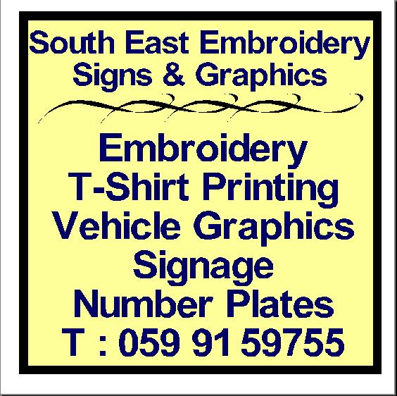

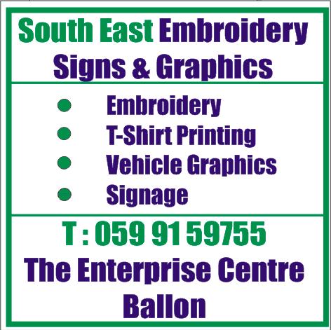

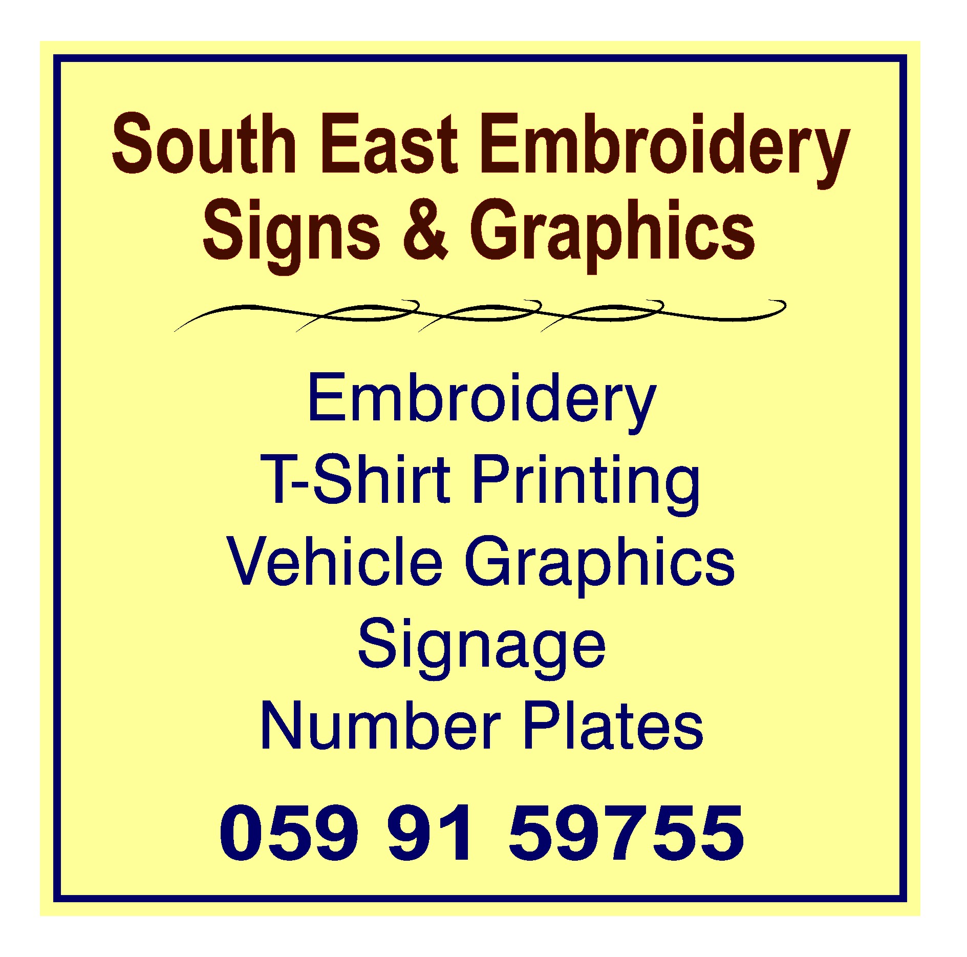

    Hi,
    Have to put up a road sign and I cannot design for myself, wanted to keep it plain and simple, here are two bad options.
    Be gentle
    Rgds
    Caroline

    9 October 2007 at 22:19
    Caroline bottom one is better colour wise, you need a different font and adjust the sizes, just a quick observation too tired at the mo 🙄
  • Graeme Harrold
    9 October 2007 at 22:36
    Bottom one definitely better, Scale the overall size down a little and increase the margin space. Allow a gap between the services and the phone number, this can stand alone just as a string of numbers.
    Guess who has just read Mike Stevens "Layout" book!!!!
  • Glenn Sharp
    10 October 2007 at 06:58
    Yep…I agree with Lynn & Graeme
    Reduce the text in size….Increase the line spacing slightly between the bullet points
    I would do your company name in a different font & colour to the bullet points aswell…just to make an obvious distinction if your reading this quickly as you pass by

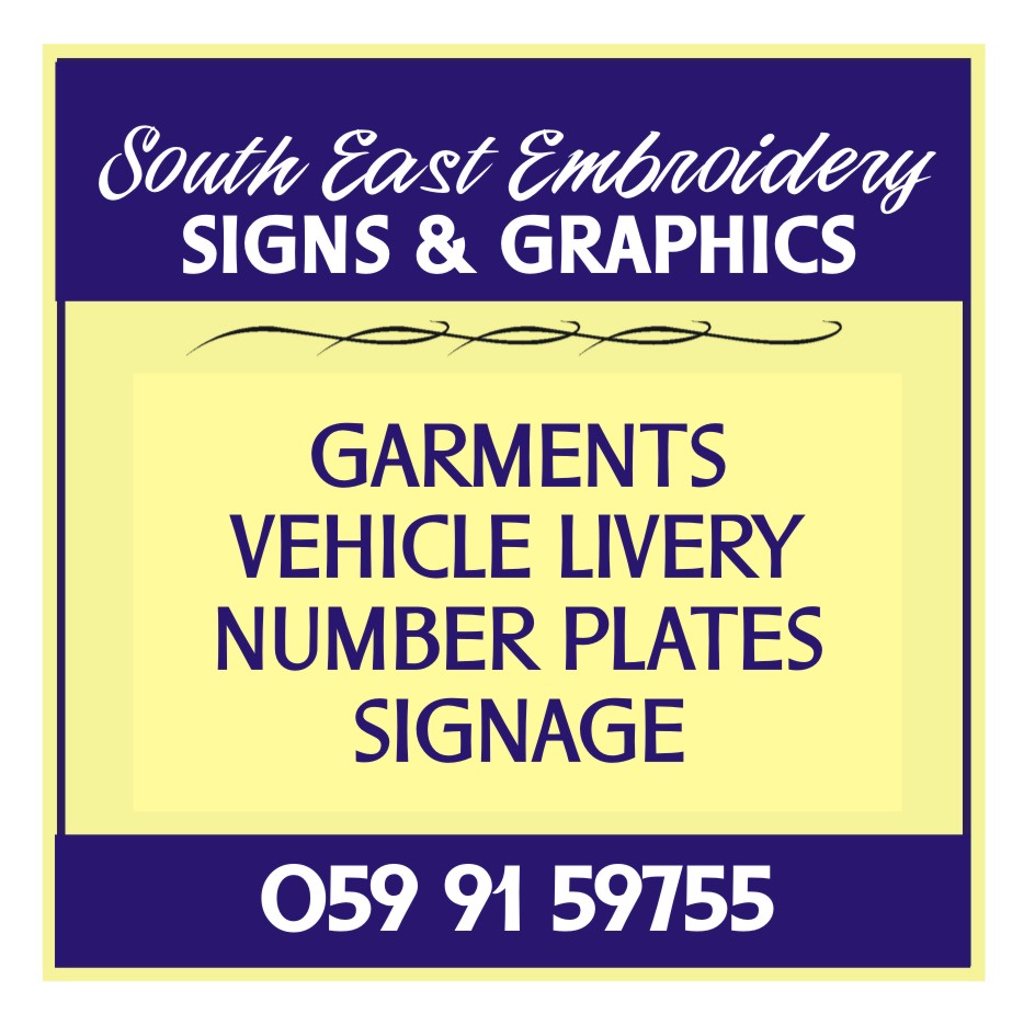

    10 October 2007 at 07:28
    Just my tweaked version of your second option

    So to be constructive, it is the white (negative) space around the graphics/text which has the most impact on your layout.
    Think of it as buying a 6 x 4 picture frame for a 7 x 5 picture.
    It cuts off and ruins the picture.

    10 October 2007 at 10:58
    Believe it or not, my views echo David’s, on a general level.
    I try to be helpful to newbies, however, because maybe one of them will listen and it will start a good seed inside of them and make them want to better themselves as sign makers. Sometimes I cringe when I see their work, but I was once there and even after 22 years I do learn something new every day, mainly from sign forums.
    I do think one must offer advice rather than just a put-down. I see that he’s apologized, and his comparison about the picture frame is excellent.
    I think more folks rushed to Caroline’s aid than if she wasn’t a pretty young thing but some hairy-knuckled bloke asking for a free Harley-Davidson logo. It’s nice to see some chivalry!
    I took Glen’s idea one step further and added the old reverse panel idea top and bottom. Gives you more bang for your buck on a simple sign. Also edited the verbiage, do you really need embroidery and graphics twice on a road sign which folks have little time to read?
    I just overlaid my stuff on Glenn’s, hence the tattoo looking thingie being a bit high.
    Good luck, kiddo. Read that Mike Stevens book. It will sink in.
    Love…..Jill

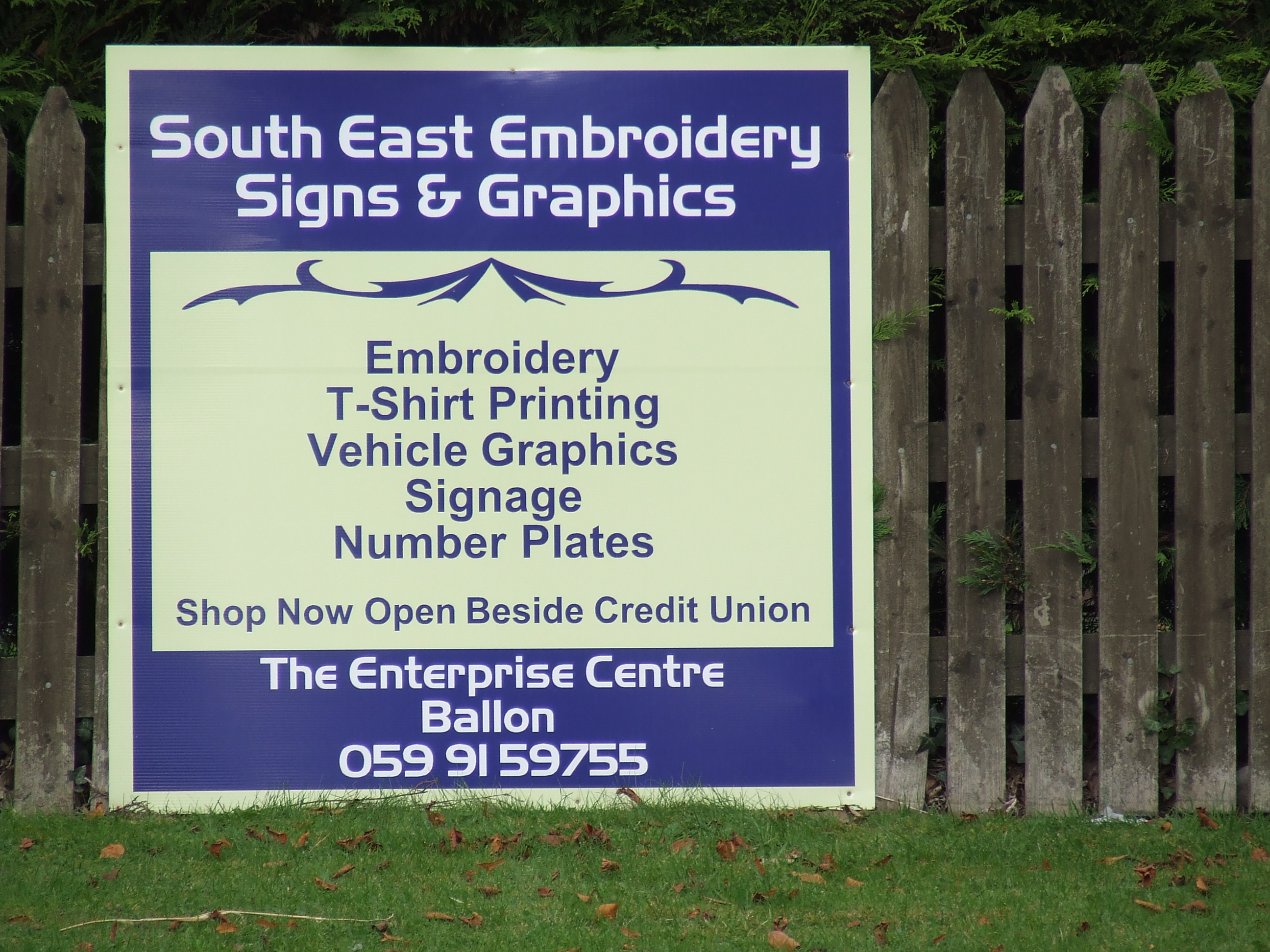

    Well,
    Its up. The sign went up yesterday. I decided to go with Jill’s idea as I really liked it.
    So I have attached an image of it up.
    Rgds
    Caroline
  • Warren Beard
    26 October 2007 at 14:16
    Very nice Caroline, it came a long way and looks great :thumbup2:
  • Tim Painter
    26 October 2007 at 14:23
    Looks good Caroline.
    My only comment would be a little bit more space above the address text at the bottom.
    Trying to be constructive not critical.
    Tim.
  • Phil Barnfield
    26 October 2007 at 14:26
    Looks good Caroline
    I’ll second what Tim said, but even so it has come on leaps and bounds since the original design.
    Looks effective enough – lets hope it brings in the work for you! 😎
    26 October 2007 at 16:53
    Caroline nice work girl, it’s nice to see you have listened and used the advise given. I also am guilty of trying to use all available space am trying very hard not to do this, as open space around gives a cleaner look.
    26 October 2007 at 20:39
    nice first sign caroline…agree with comments made, and also the main heading should be higher so there is less space at the top than the bottom…so when the eye looks at it, it looks even… hope it keeps you busy 😉
  • Simon Strom
    26 October 2007 at 21:06
    Looks good. I agree with some of the other suggestions though. I use a general rule of thumb (of course I don’t always stick to it strictly) of a half cap height for leading (interline spacing) for copy that is part of the same thought. Usually if the thoughts are more separate I’ll use a full cap height. Also typically I use at least a full cap height when copy gets near any type of border (be it a rule line or the edge of the part) I’m going to attach two drawings that I recently did. Some of the spacing might look misleading as I used small caps. These actually have a half cap height height for each block of text with more than a full cap height for different thoughts (already breaking the rules) Just keep at it though. Like anything else, the more you practice the better you’ll get. 😀
  • Richard Urquhart
    26 October 2007 at 21:09
    I would just like to follow on a little, firstly well done on taking advice and completing your sign. A few years back I painted cars for a living and did very well from it. I started painting bikes and needed decals cut and started doing them my self I spent what money I had on a good plotter which helped but the best help I had was from Uk Signboards and its members, having stopped painting full time now for over 2 years and full time sign making I always thanks the boards and its members I,m glad I didnt get the comments that David chose to use.
    Rich
