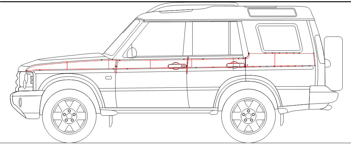

    Hi I’m new to this forum and new to the business doing this as a hobby and becoming a small business
    Basically i need a bit of software design advice. I’m currently using Corel 6 and winPCSIGN
    I have recently purchased Impact Vehicle Library (current edition) and want to create batttenburgs down the side of a car in effect to make it into an ambulance. (Most of my contacts are in the medical field)
    I’m currently playing around with software using a discovery 2 and making 7 panels per side (yellow and green) which will be top of door under the window and middle of door – im making each panel about 10mm smaller than the line
    Has anyone got any tips to create these panels as its so time consuming

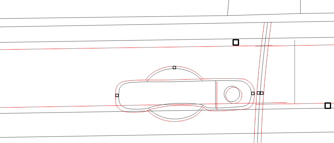

    What i have done so far is made 10mm boxes and placed them across the panels for guidance. with straight lines i have used a normal line but curves i have copied and pasted from another image of the discovery and brought it forward 10mm – i have grouped each panel (i.e complete wing) so it can be cut however as you can see from the front wing the compete wing would be 3 colours (the first change of colour by the wheel arch the second by the indicator)
    There has got to be a quicker easier way to do this and get the curves spot on and be able to cut one panel at a time to avoid wastage –
    i really hope i am making sense here and any advice would be greatful
    (i did try b4 throwing in the towel lol)
    Chris Windebank replied 11 years, 4 months ago 8 Members · 8 Replies
  • 8 Replies
  • Adrian1974
    13 May 2014 at 22:19
    btw the red would be the cut line
