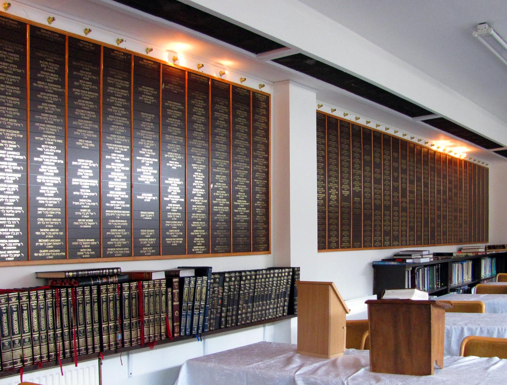

    I can’t help you! but I’m desperately searching for a company I can subcontract, that still uses a Gerber Edge. I need to match an existing installation that was printed in ‘gold leaf’ foil (shiny gold) on clear vinyl by a Gerber Edge. Photo attached.
    Please reply if you think this is a possibility for you!
